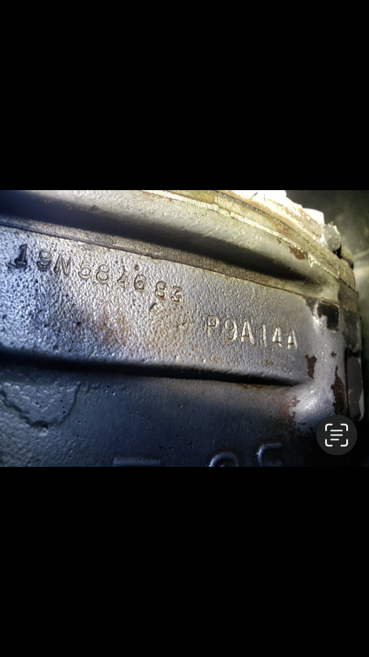

Hmmm
Doc

Hope the drivetrain is still in the RS Z that matches the VIN in this car sold in 2021
https://bringatrailer.com/listing/19...s-302-4-speed/

Transmission VIN looks pretty good to my untrained eye, but I'm a Chevelle guy, so I don't pretend to be a Camaro expert.
Engine VIN is terrible restamp.

That muncie "P" looks to narrow.

I always thought the engine VIN and transmission VIN were done with same stamp. These were not
