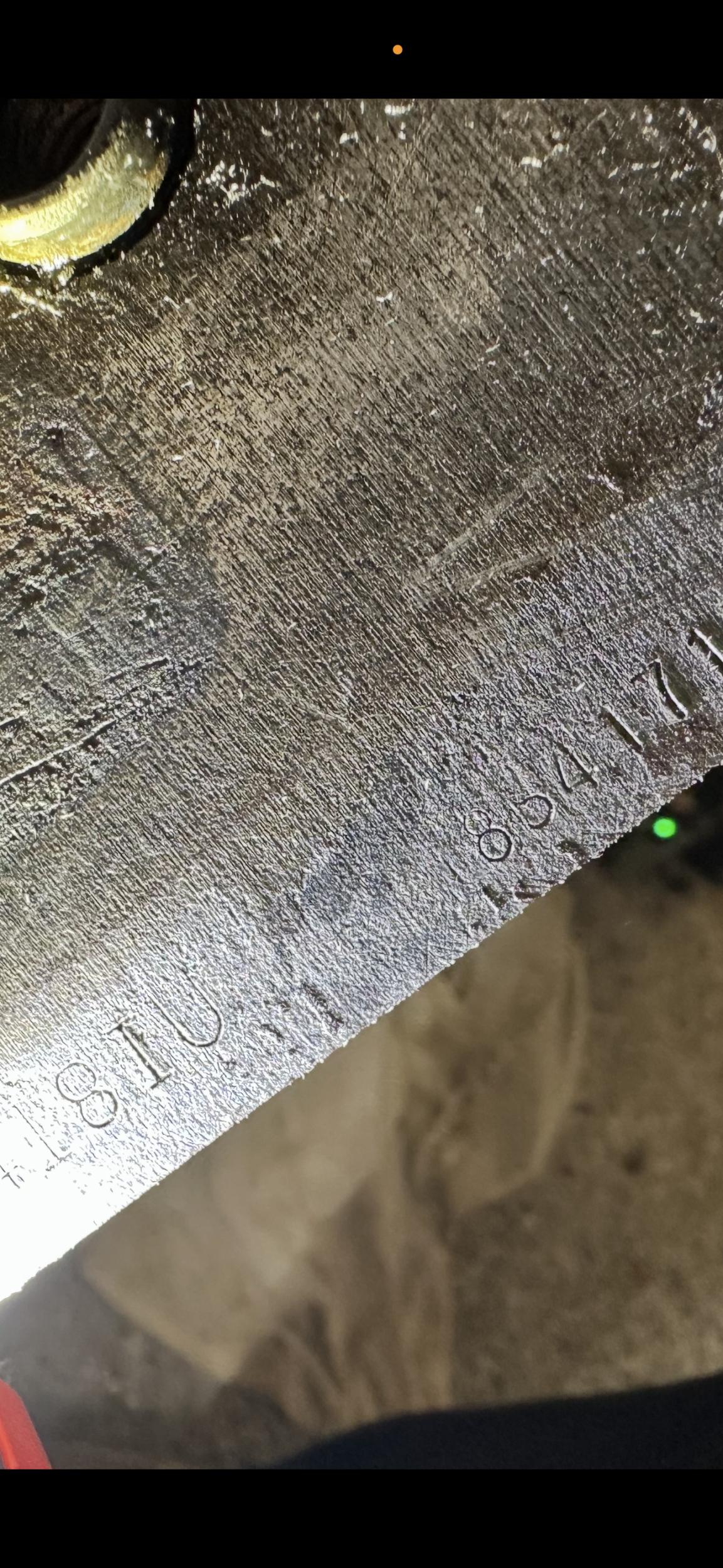

That VIN stamp does not look like it was stamped with a gang stamper the last 5 numbers look like a heavier stamp, looks like you destroyed your concrete driveway

Of course it was stamped with a gang stamp. Were they done any other way?
You’ve been around long enough to know there can be nuances with stampings.
I had the stamping certified by Corvette Validation Services( aka Jonathan Herrick)as original.
The original drivetrain was in the car and the transmission has part of its vin lightly stamped also.
And of course I have the tank build sheet.
Interestingly, I had concerns about the block casting date (3-25-68)being so close to the assembly date (4-18-68), which was also close to the car’s assembly date(4-25-68).
I called Jonathan ( he has the L89 registry and owns Corvette Validation Services and he had several cars in his data base that was very close to my car.
If I remember correctly a couple of L89’s whose vins were close to my car had the same exact Tonawanda assembly date as my car. Apparently these L89’s were batch built.

I've noticed on several TH400 Vin stampings that the last 3 or 4 digits are not even with the first digits. My guess is that the factory stamped the first two or three digits knowing the car would be in a certain range of a thousand cars and left the last three or four digits until later in the assembly.
Maybe that's the case here? The digits fonts are all good.
