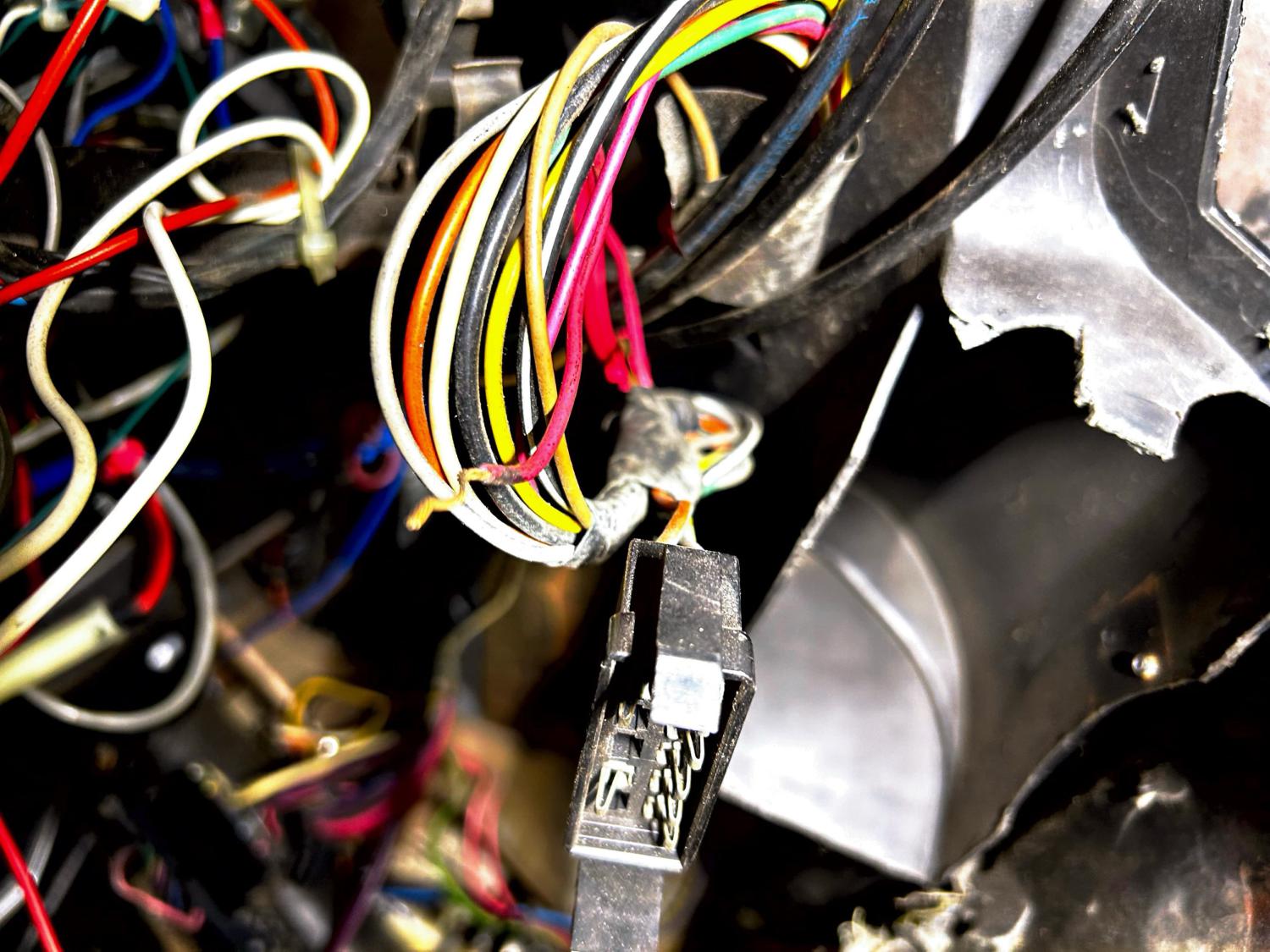

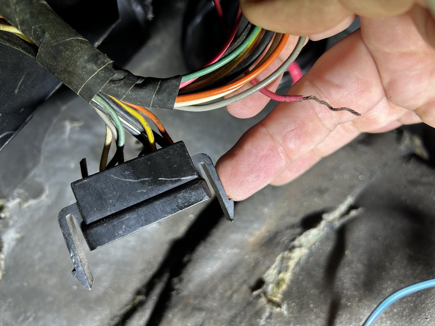

So, I happen to be under the dash tracing some wires and noticed a harness for Console Gauges. My question is: Are gauge harness prewired from factory or is it safe to assume they are added only when U17 is optioned

Take a Clear Photo of the Face (aka Pin Side) of the "Console Wiring Harnes Under Dash 12 pin-Connector" & we can decode the Pin out arrangement to tell VERY easily if the Harness was set up for D55 Console Only or D55 & U17 Console With Gages.
Added some pics in original thread
I’ll take another pic of face of harness

So, I can't see the wire colors in the rectangular connector the way you took that pic, we will wait for the new pic. Here is a post on Team Camaro showing the gauge wiring diagram:https://www.camaros.net/threads/wiri...gauges.467971/

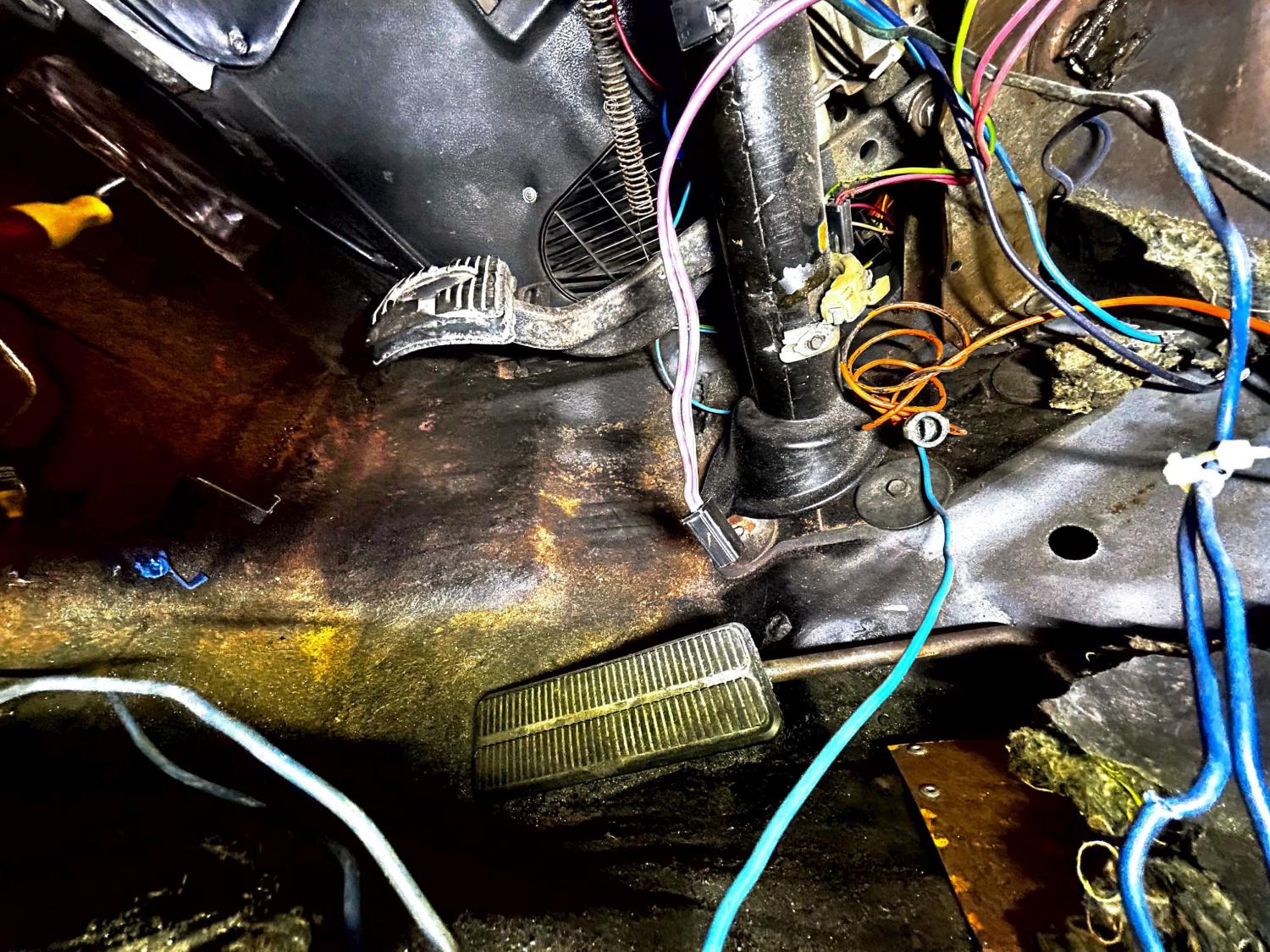

Also the pic with the purple wire connector is for the clutch safety switch mounted on the pedal support.
