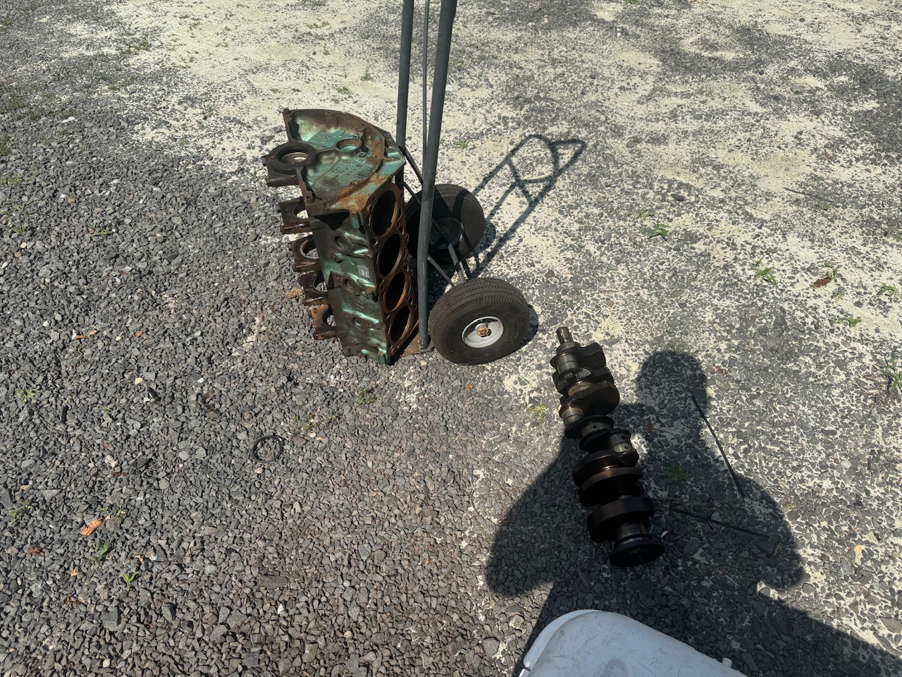

The short block is another 100 dollar 360 I picked up that was remanufactured at some point in its past. It’s bored .040 over at 4.120 and the crank is .010 on the mains and .020 on the rods. I’m not using that crank though as I have a nice uncut standard 360 crank I was given months ago.
My current plan is to go to 4.155 bore(stock is 4.080) and have the crank cut offset to increase the stroke to 3.66(stock is 3.44) with NASCAR 6.200 rods that use a 1.850 rod journal. They’re super cheap on eBay. I’ll just need pistons made for it which a friend in the AMC community is offering to help me spec so I get everything correct.

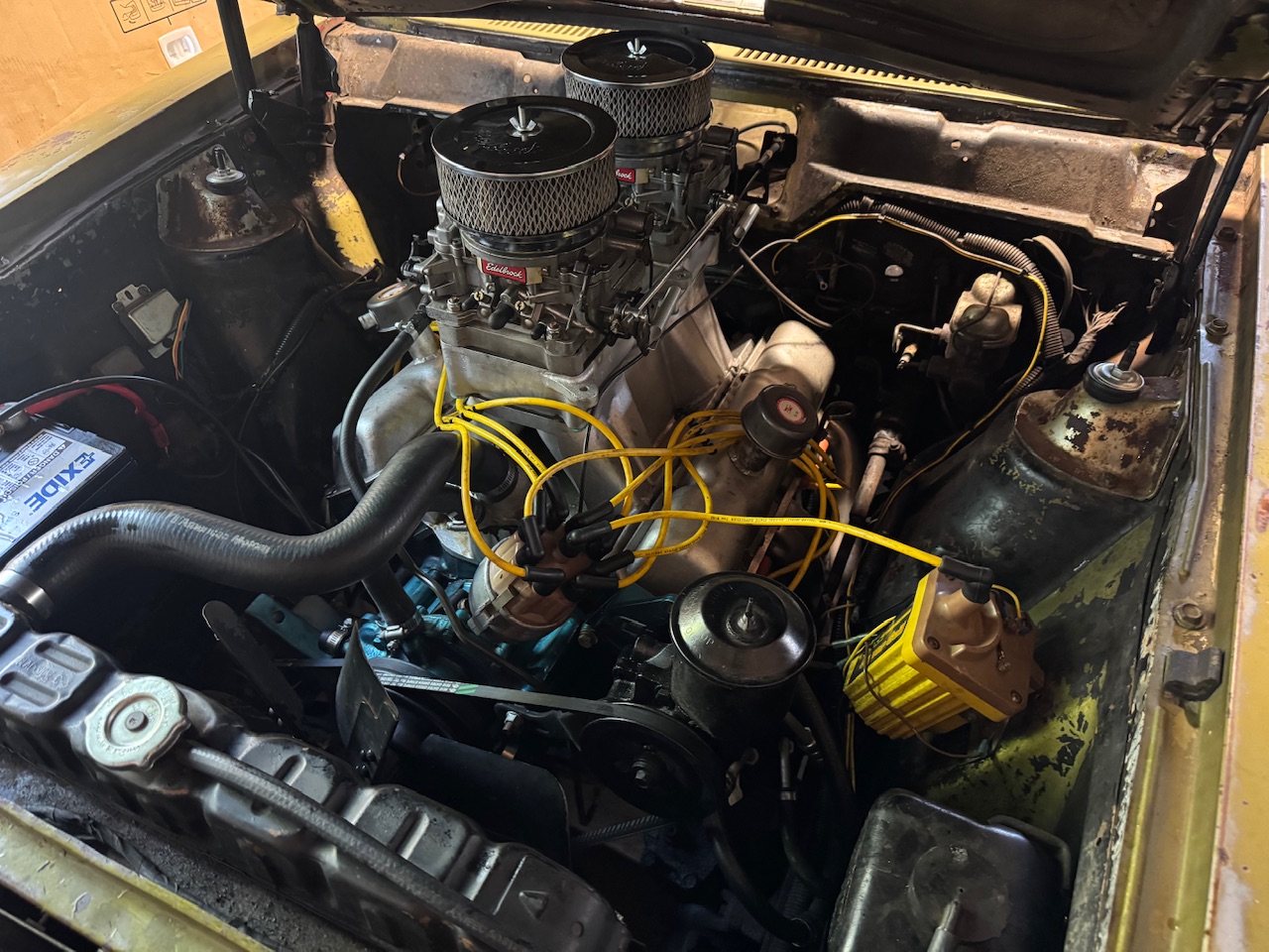

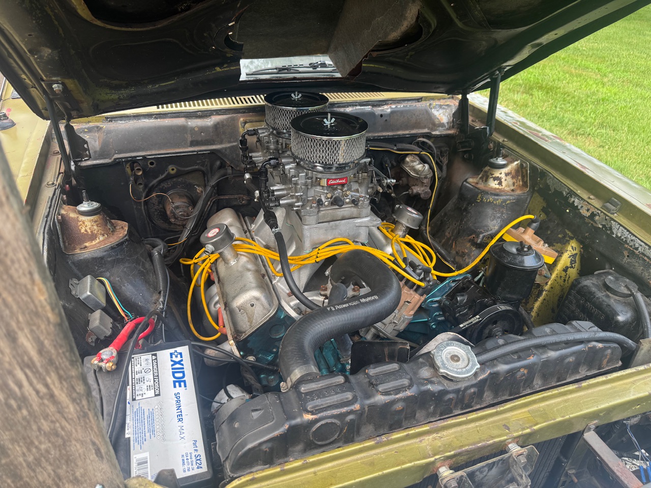

Got the car washed and ready today. Tightened up bolts and went over things so I can drive the car around Kenosha for a couple of days. I also changed out all of the gauges from the garbage that Williamsons instruments did for me. They suck by the way. To an old pair of SW gauges and A 55 year old Sun Super Tach signed by Richard Ruth. I met him at MCACN and have been lucky enough to strike up a friendship with him. He signed this Super Tach for me at the show. I wanted this one signed because it’s the exact model used in the 55 in Two Lane Blacktop.
First picture is my dad and I at Carlisle Chryslers. We only stayed Friday but had fun.
Next couple of pictures is working on the car getting it ready for Kenosha. The front wheel bearings needed to be tightened a touch and the front drums needed to be adjusted. I greased the front end and replaced the fuel filter. It was clean but has been on the car since I put it on the road over a year ago.
