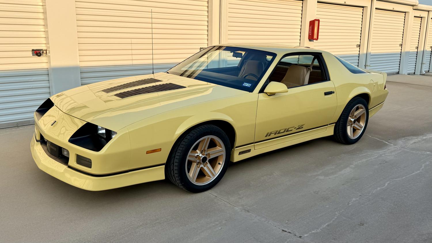

After seeing some cars that I thought were priced too high, I ended up finding this 55k original mile hardtop.
It has had a repaint but it appears mostly original other than that. No rust at all. It's a base LG4 305/automatic which was fine with me because my intentions were to LS swap whatever I got. I started having 2nd thoughts about that because this car is so nice and original and I really don't want to mess with that.
I do appreciate a nice, unmolested car so I decided to put the LS swap on the backburner and just fix all of the little things that were worn out or broken due to age and then drive it as is until I can't take the 155hp any longer.
The car was sold new at Byers Chevrolet in Columbus, Ohio and appeared to stay in Ohio, with the original owner until about 7 years ago. It changed hands a couple of times before I bought it.
I found part of what looks like a broadcast sheet under the carpet in the rear.
I've changed all fluids, replaced old brake lines, hardware, , bushings, broken plastic clips, fuel pump and I had the CCQJ carb rebuilt. It ran well so I was happy......was.
My wife and I were cruising when the oil pressure dropped to almost zero. I pulled over and saw that it had plenty of oil so I thought maybe my gauge is just faulty. Decided to limp it back home and listen for noise. It made it home ok so I drained the oil and I found bearing material. I think what happened is that a bunch of fuel got into the crankcase because of a bad fuel pump. I went through 3 aftermarket fuel pumps because they were flooding the carb. I ended up finding a NOS fuel pump that solved that issue but I didn't even think about the oil getting contaminated with gas.
So, now my LS swap plans are back on the table. If I'm pulling the LG4, I'm just going to replace it. Let the fun begin.

I added a set of 17" Hawks Iroc replica wheels. I've just been driving the car and enjoying it. LS swap is still on my radar but I'm in no hurry. The car is holding oil pressure and running nicely so I plan to keep it stock and just enjoy it for now.
