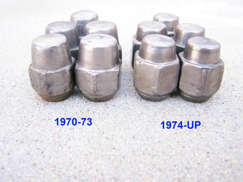

What wheels do these GM lug nuts go on
Attachments - The Supercar Registry StainlessLugnutComparison.Tex.t.jpg IMG_5732.jpg IM000006.JPG 70-73 vs 74 & UP Lug Nuts Rally AND Z-28.jpg

5.813 Mag Rally Sport SS Wheel Capped Lug Nuts GM # 414188 Replaces9780732, 9789086, 399683, 1231722. THISIS LISTED FOR THE FOLLOWING APPLICATIONS: 1969-79
Chevy Olds Pontiac Rally wheel

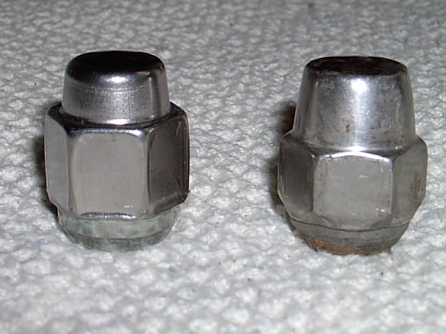

GM parts book show that part number 1231722 was switched in July 1974 over to 414188.
That lug nut in the original post looks like it has a rounded head or am I seeing things?

Default Heres what they look like
I have 4 boxes of 5
