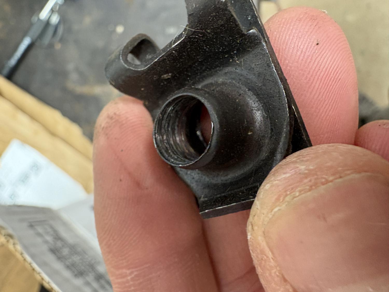

Originally Posted by William View Post
Here in WI, the nuts break off the clip. The cone style is far better.
This is the result leading me to go back the OEM route with factory j clips.
3 of these clips stripped out way before I could even torque to spec. All by hand. I wouldn’t trust these.
Here’s an example.
Old 04-08-2025, 03:46 PM
enio45 enio45 is offline
Location: Gilbert, AZ
Posts: 4,329
Thanks: 525
Thanked 460 Times in 266 Posts
well that def is a problem, wonder if different manufactures of these are the problem?
I like the orig style and would probably do a spot weld on each nut to be sure they don't break loose.
