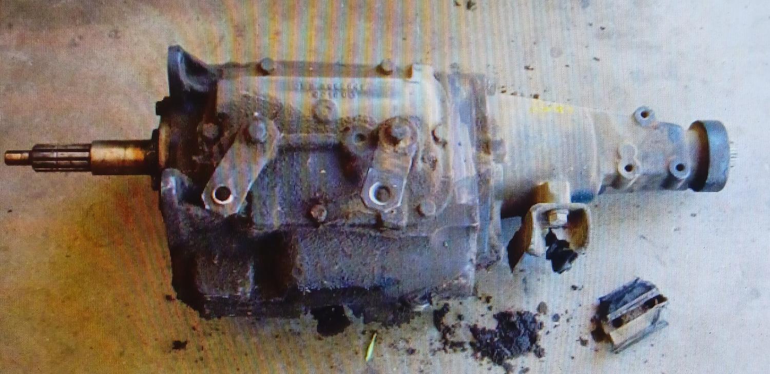

Is this the setup you are talking about? This is a 69 Saginaw 3 speed HD from a big block Chevelle.

If that is out of a 69 that is a Muncie MC1 3 speed. I don't believe a saginaw was offered for the chevelle that year either. There was a saginaw that resembled the muncie. Does the one pictured have the 5/16" two piece ball? Flat side shifter? Bench was flat buckets said muncie, I believe.

Default sure looks like a Muncie to me
Looks to be a Muncie.
