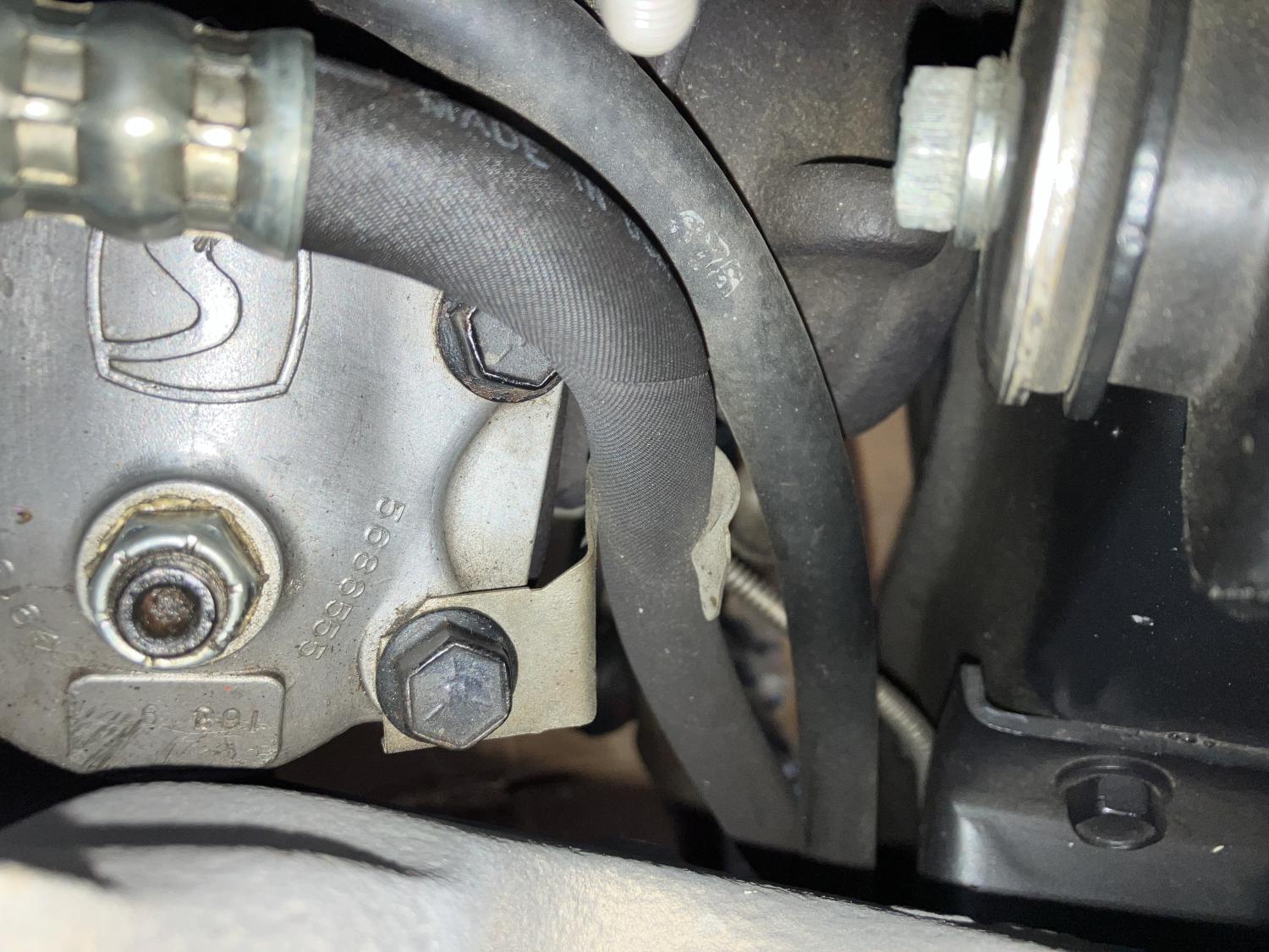

I came across this power steering gearbox this weekend and was wondering what it’s for.
Julian date 163 9
Cast # 5686555
I went to the GRC site and it appears it’s not for a 69 Camaro.

Look for the casting number on the cast iron housing. It should be 5679142.

cast & power steering is 5691676

thats for standard steering

It’s on my 67 Camaro. I was fishing for info to determine if it was correct for my car.
