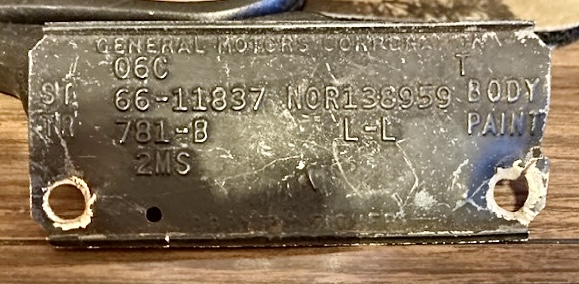

Here is a 66 Nova SS trim tag removed in 1978 for comparison. It's also a Norwood car (most were willow run)It has the hole referenced by that GM bulletin

Looking at both, I see quite a few differences.

Comparison

^^^^^^^ glaringly different, side by side.
