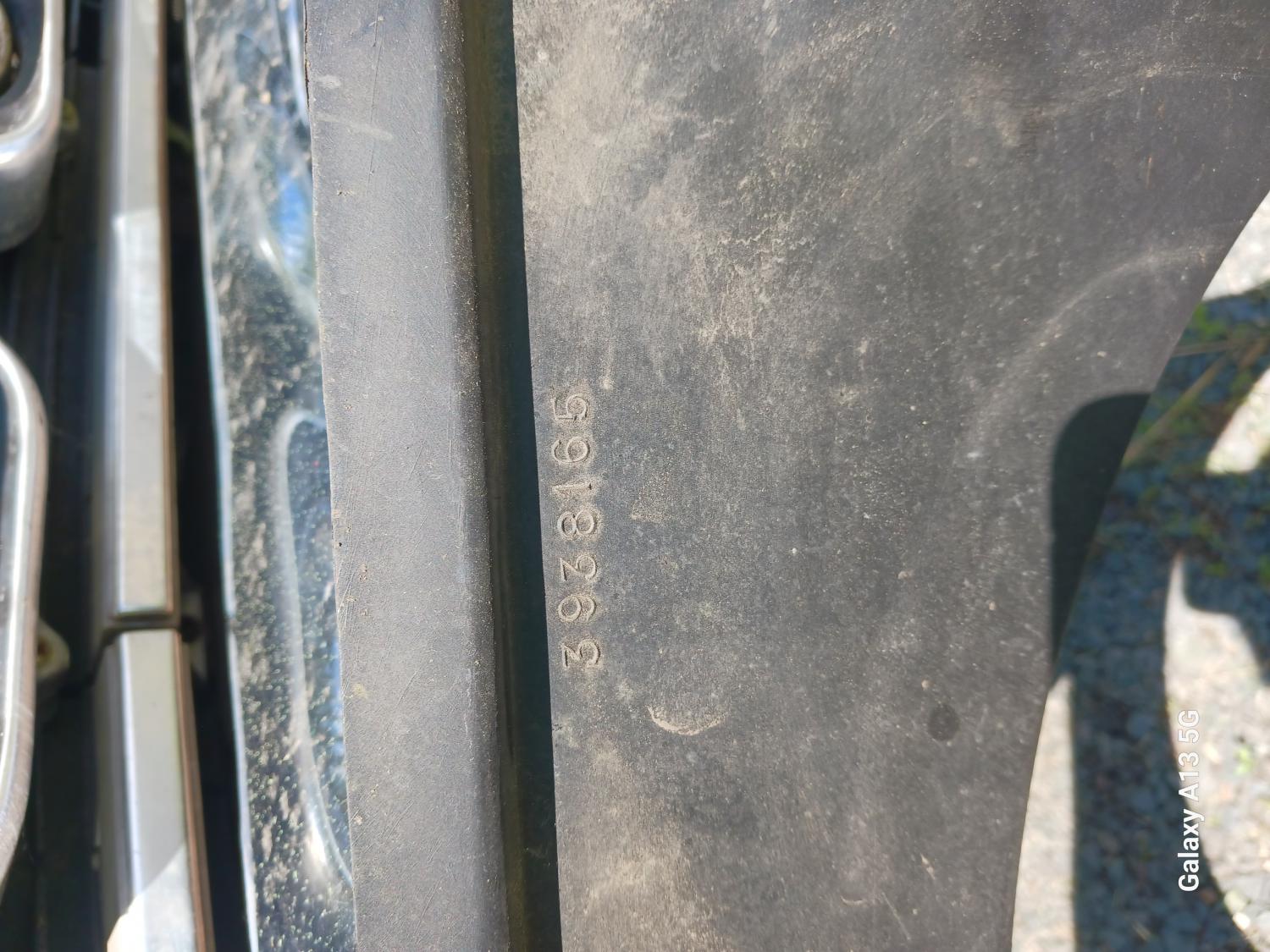

Where should a details of "OLE BLUE" thread be? This one? A few random pics od Anns car.

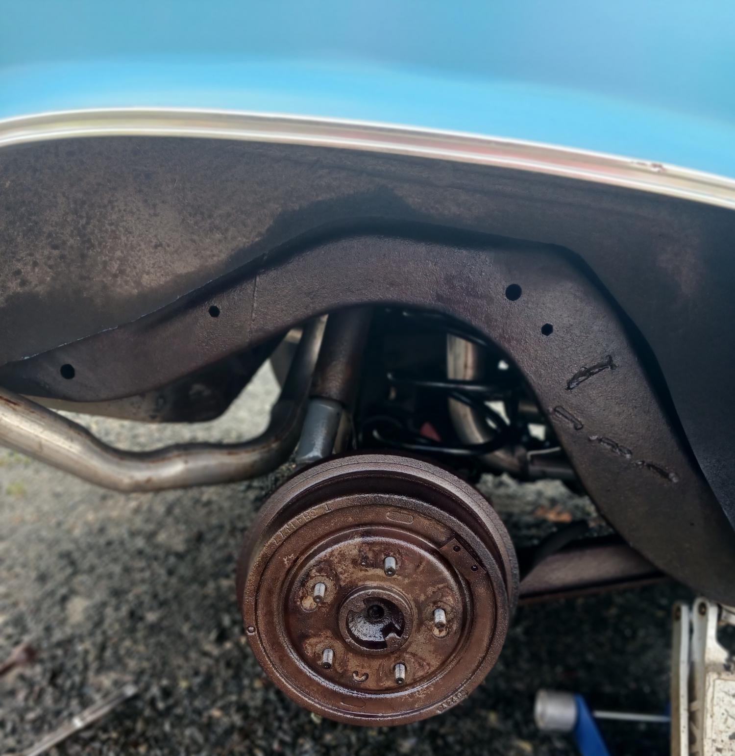

more random pics. Better view of starter heat shiels and floor after first round of cleanup. There was a short "barn find" write up on this car when it was for sale on epay. Described as rotted out doors etc and maybe some originality. Doors look rotted out to you? Crappy looking floors cleaned up very well. Mainly staining. That clip and crappy looking pics just about scared us off also but very glad we bid on it. Did not know it was a MSS until I drove it. No mistaking a low mile M22 whistling for you.

Great detail photos. Thanks for sharing. Is there a particular product you are using to clean the rust off?

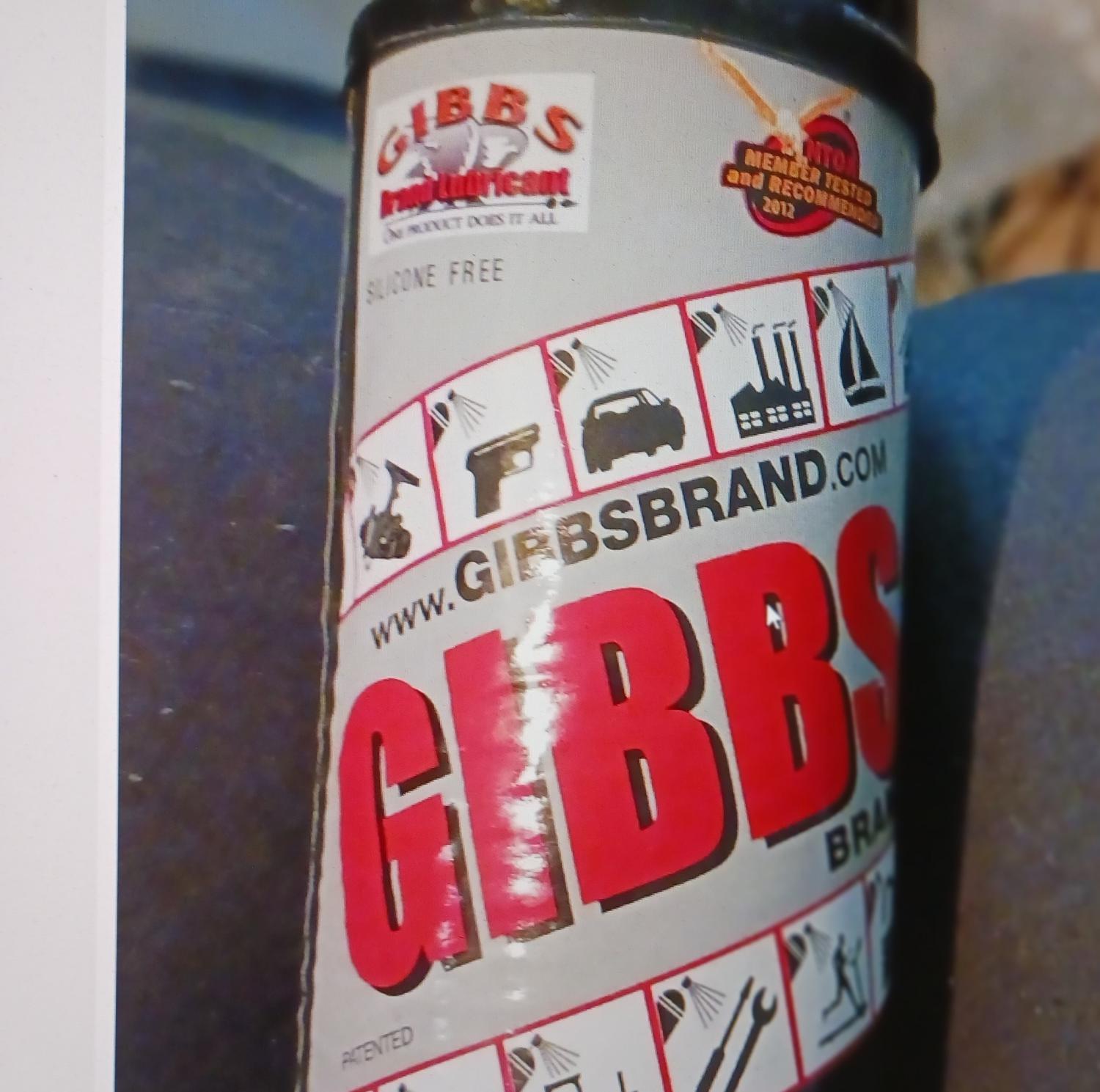

Gibbs oil and a soft brass toothbrush. Coarse ore stainless hurts paint. Fine steel wool works well also.

i buy it by the case on epay.
