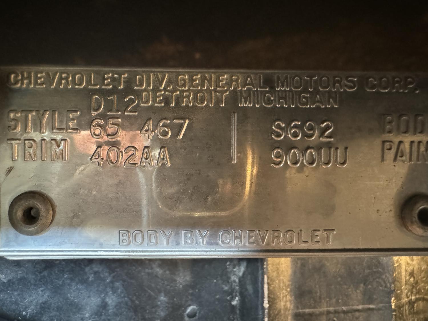

Would like everyone’s opinion on this trim tag. It is on a 65 Corvette. Thanks in advance!

Is the tag that rough or is it the resolution of the pic? Not sure about the rivets. What's the VIN?

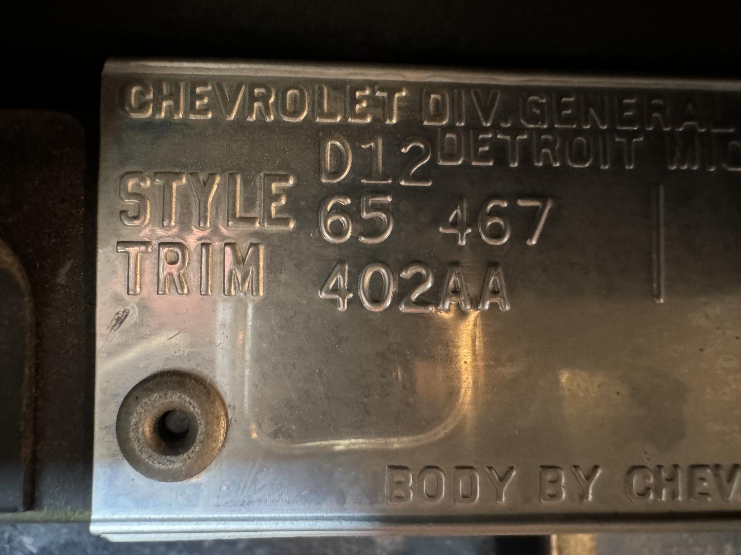

Might be the resolution. Is this any better?
Still hard to tell......at least for me anyways. I tried to blow it up and that kills the resolution

If you magnify the "C" in Chevrolet, you should see marks like teeth in the top part of the "C" where it starts and the bottom part of the "C" where it ends.

Is this a car you're considering purchasing?

Yes it is

Any better?

bbjohnny,
I'm studying your tag. Your last 2 photos were the best but please post 1 more clear shot like those but now show the entire tag centered showing both rivets. Looking straight into the rivet holes. That'll do it.
