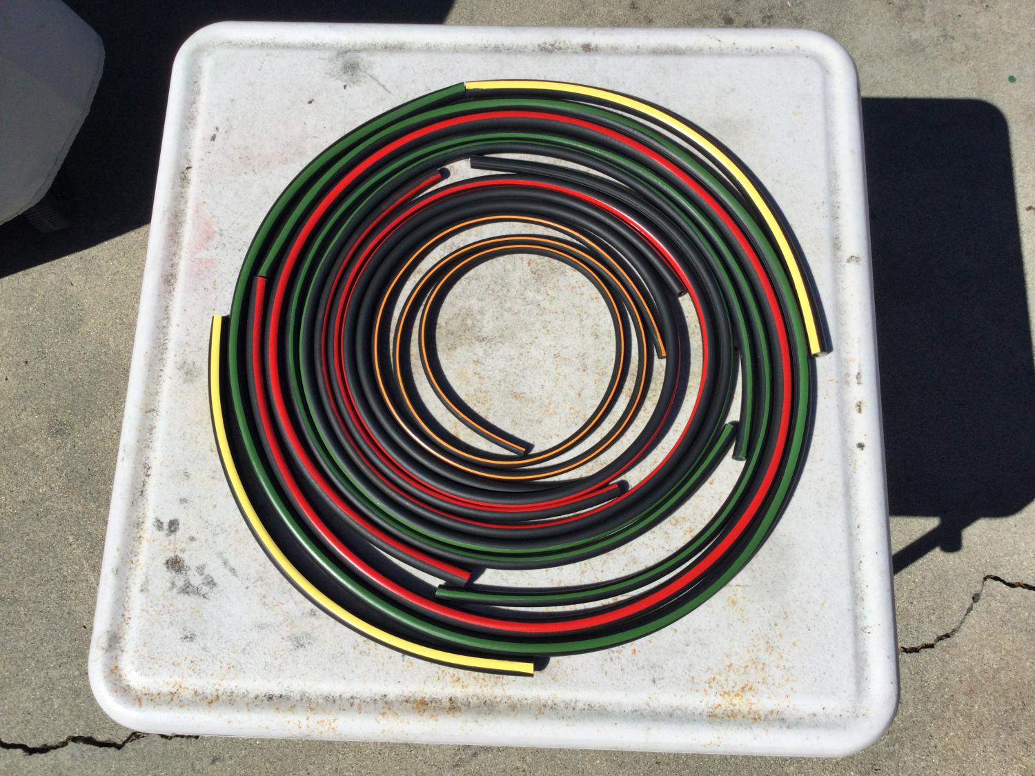

Is there anyone reproducing the correct vacuum lines with the correct orange stripe hose to the headlight switch

You mean like this?

yes

I posted a DIY to re-stripe and color-correct the Orange, Green and Red striped replacement aftermarket Rally Sport vacuum hoses available from most Camaro parts vendors. The process is detailed on Page 40, starting at Post #795 of my build thread on Team Camaro. Here is the link:

I took Edmontons willingness to help and then did the entire kit. I have found the Norwood and LA cars in 1969 have slightly different widths on some hoses, but the orange is the same. For some reason, the 2 different suppliers can’t seem get the colors and striping correct….I digress.

Thanks for sharing,I've seen others attempt these stripes on a hose free hand and the result was not very good at all.
You both did a great job.

These looks great! You guys could market a "correct" kit! : )
