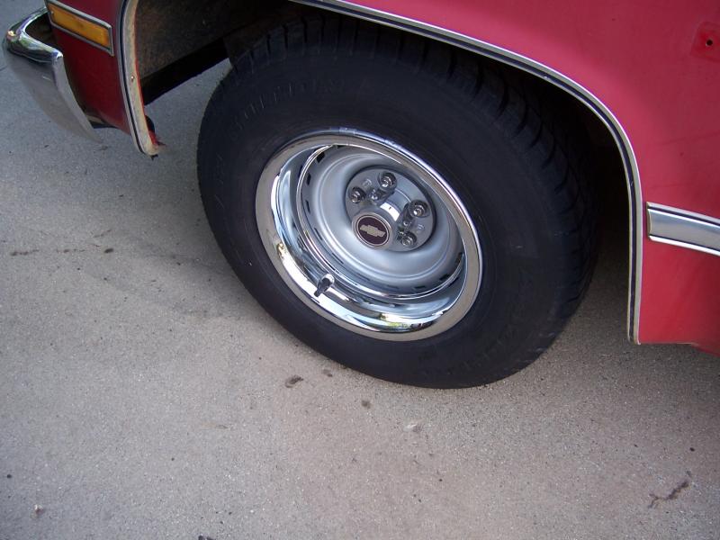

It's true -
Chevy pickups as far back as 1975 have used a stainless cap nut.
I will say this: if you can knock the stainless cap off you can use the next size smaller socket on the base steel lug nut to get it off.
