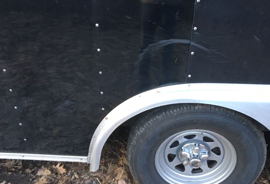

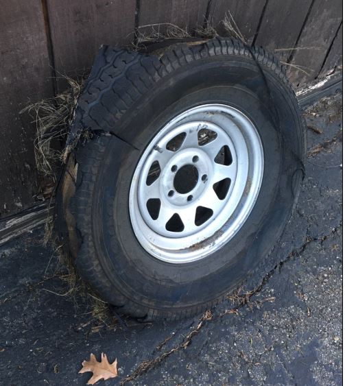

Check your trailer tires. The Super Car Reunion is coming up this Friday, and we always have a few guys show up who had a trailer tire blow out on the way. I was getting my trailer ready today and thank God I noticed this. If it had been on the back side I probably wouldn't have noticed until it blew out. $750 and a few hours later I've got a new set of GoodYears on it. This could have been bad. Theses tires were 6 years old.

Good reminder and catch, Freddie. The wear on the separated blocks indicates it was coming apart the last time you pulled the trailer too, lucky man.
Check air pressure !! and keep them at, or near max, as the load rating is based on that pressure. Running the air lower than max also reduces the load capacity, which allows more sidewall flex which builds heat in the tire and heat kills tires. I have load range E tires on my trailer. Way overboard for the gross weight of the trailer and load, but I've never had a tire fail either.
As an aside, I have a 2013 travel trailer that the spare had never been off the carrier and 2 years ago, it separated and was coming apart. The quality of tires has deteriorated dramatically with many of our tires now coming from china.

I was in the habit of replacing my tires every 5 years. Your post is making me reconsider that. I'll also add to the conversation, I can only suspect spread axles and tight maneuver's tax the side walls on the tires (to say nothing for the wheel bearings).
I'm assuming most trailers are sitting outside, thus UV is raising hell with them. I have the luxury of keeping my trailer inside. Considering the cost of these trailers, I'm treating them like the rest of my vehicles.

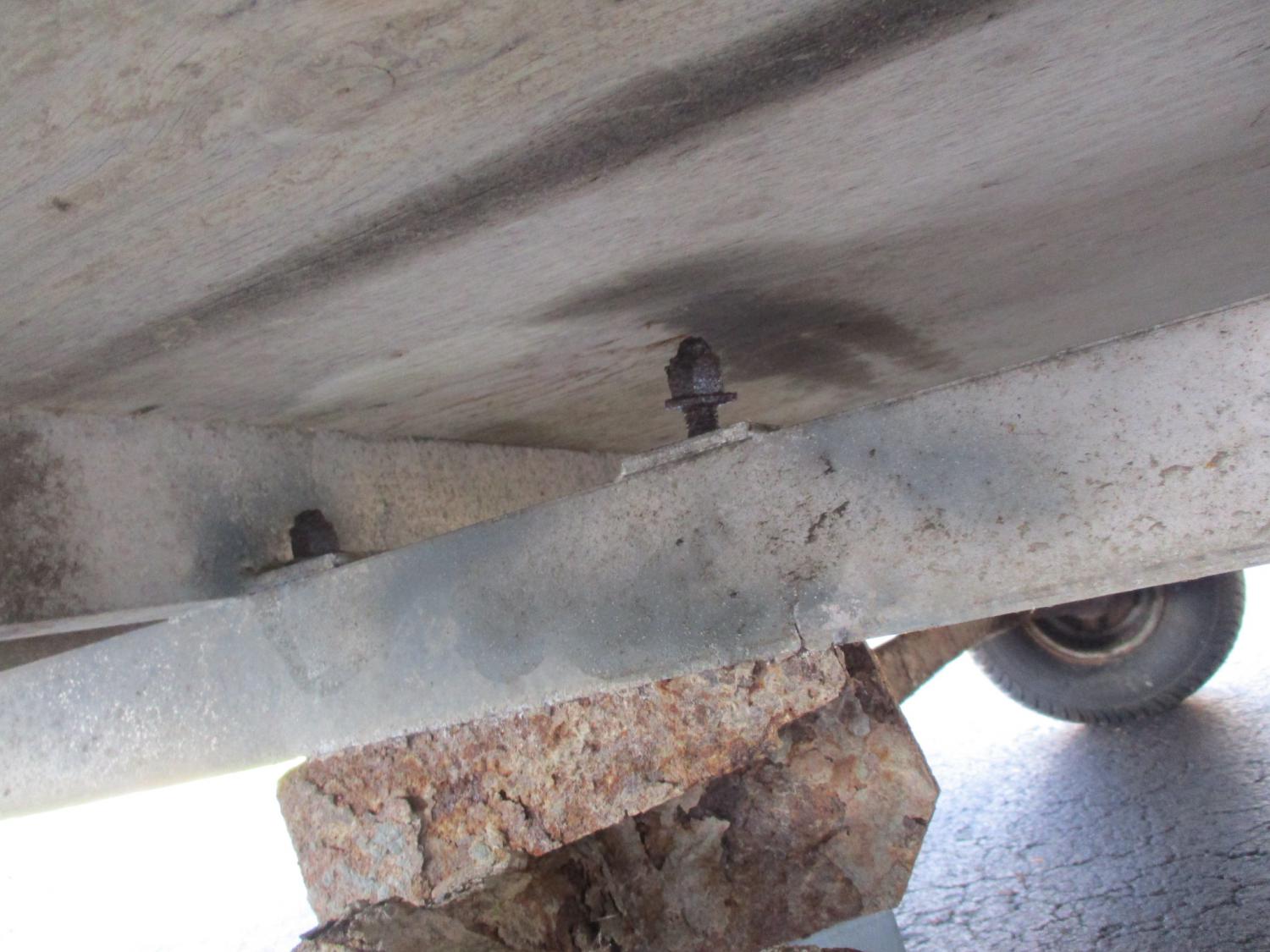

Checking tires is a great idea...and also looking at the rest of the trailer. This past December I decided to repack the bearings on our snowmobile trailer...it sits around for 9-10 months without much use. Tires looked a little cracked so I ordered new wheels with tires already mounted.
When I went to swap them I noticed something strange with the axle mounting point onto the trailer frame. After a little inspection we found out the steel axle had corroded the aluminum frame and the axle was sucked up into the trailer frame, both sides
The axle company called it 'galvanic corrosion'...mix steel with aluminum and add the salt...recipe for disaster. Fortunately I caught it in time...we installed a new axle and two new aluminum frame rails.

Great points Wilma!! Mindful that my trailer has rolled 115K miles, I roll around under it at least a couple times a year looking for any issues. I pack wheel bearings at 10K and carry a spare hub/brake assembly.
And steel against aluminum,
The steel axle support rails under mine are separated from the aluminum trailer frame by heavy sheet plastic, all bolts are stainless.

Yes, on the separation of dis-similar metals. All it takes is a layer of clear packaging tape. Hope you did something similar, Wilma.
In the early-mid 80's Peterbilt was done with their mild steel west coast mirror frames rusting prematurely in the salt states and went to stainless brackets. Several years later, they learned of their mistake when the paint around the brackets was failing under warranty and the corrosion issue was discovered. Cost them a bit to replace doors for a while. Even my '92 didn't have any insulation, which I added as soon as I bought it, in '95.
Bill, I don't use stainless bolts, as they will still react where they touch aluminum. I use grade 8 bolts with a zink coating and anti-seize on them. I install them in a manner that I never have to turn the bolt and scratch the zinc, only turn the nut...
