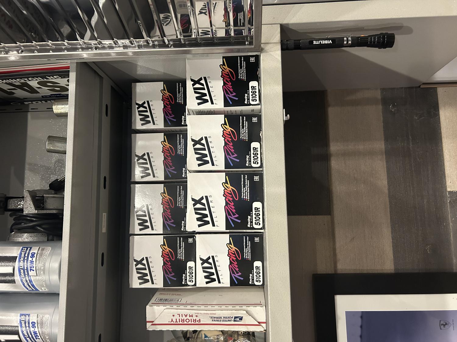

I will soon be draining the break-in oil (BR 15W50 recommended by the machine shop) from my flat tappet 454. What are the experts oil recommendations for this engine? Thanks in advance! Craig

You'll probably get a bunch of answers here. I use Valvoline VR1 & always a Wix 1st line filter. Napa 1st line used to fit in that group but unless it say made in the US, it's not a wix in the NAPA box....Joe
