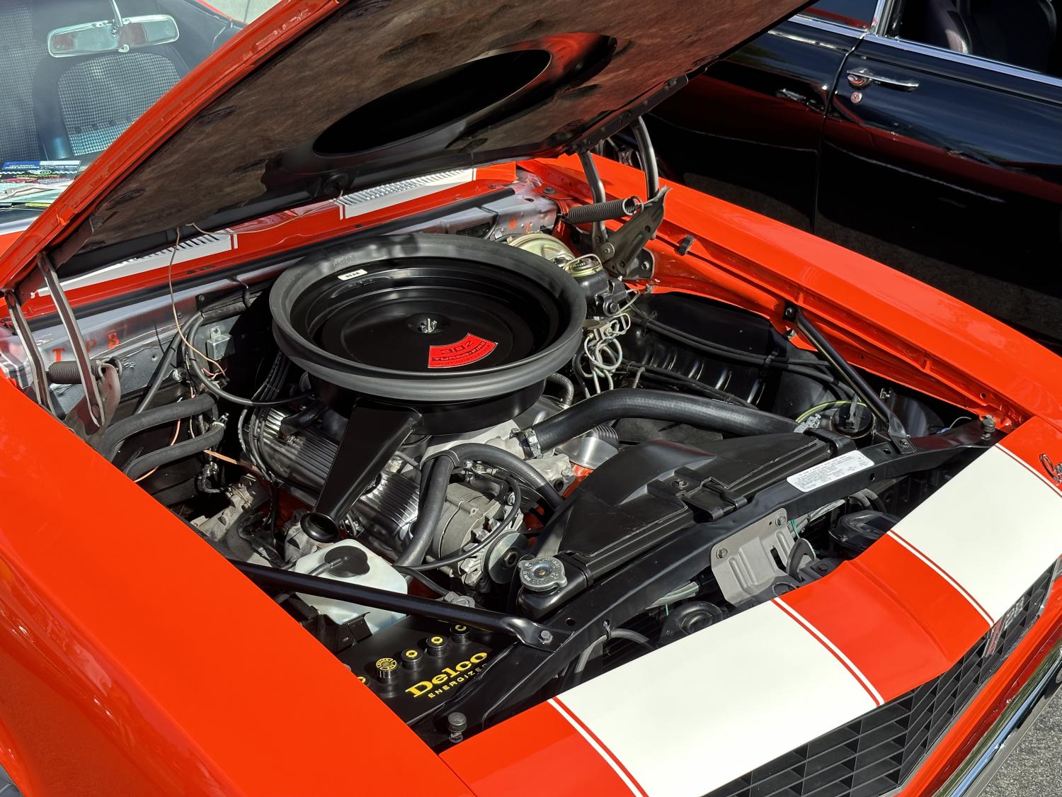

Working with Kevin at Coil Spring Specialties was great. My first set came out at 25 3/8” to the bottom of the front fenders, with 215/65s and rallys. My second set I just did same specs but -1” ride height and they came out right at 24 3/8”. I bet if you just ask about the orders from Matt from California, they can dial it up or down for whatever you are going for.
Here’s a dash of Hugger Orange and chambered exhaust for everyone’s Sunday:

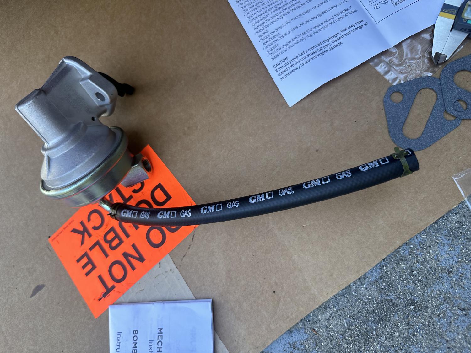

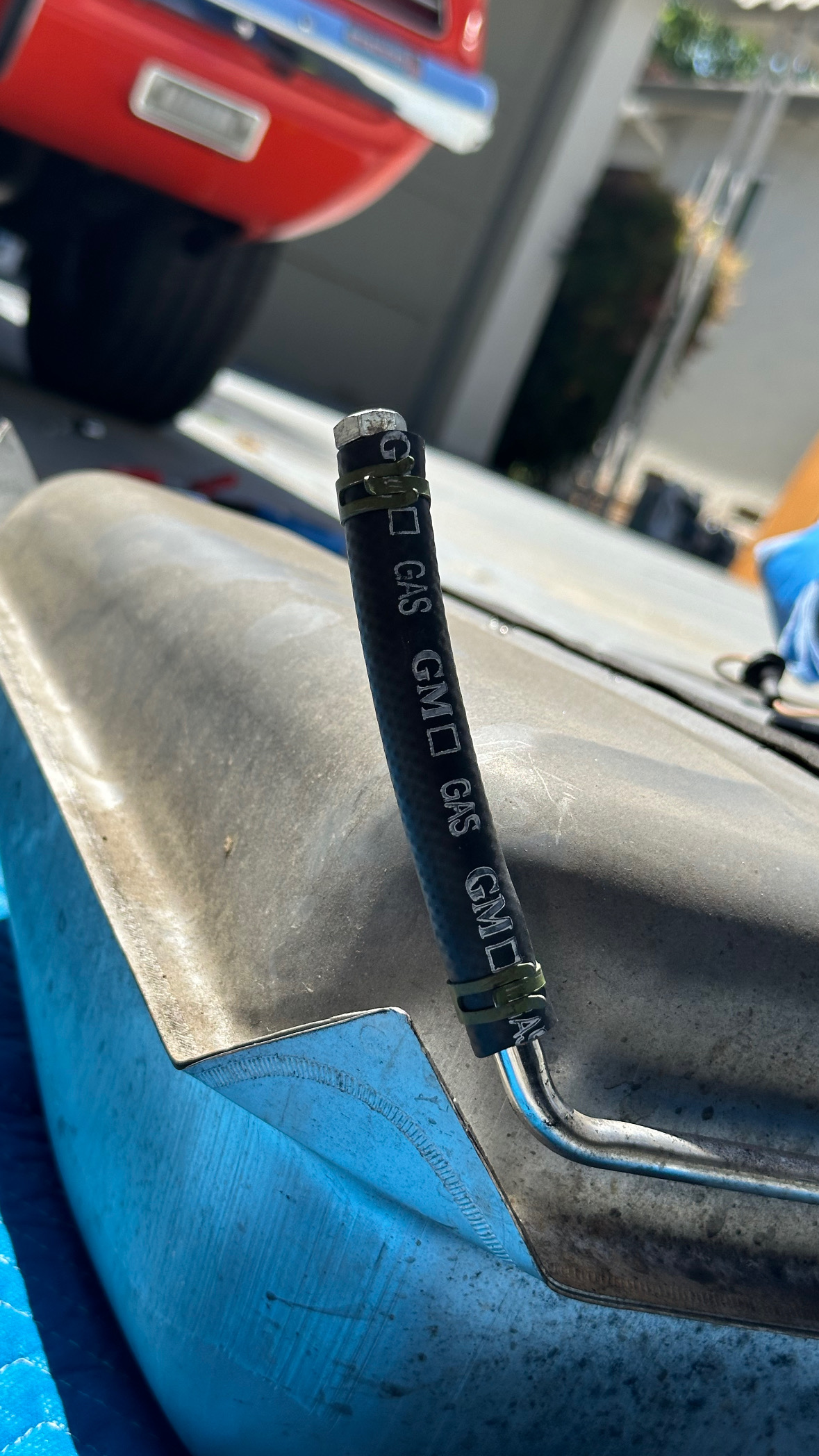

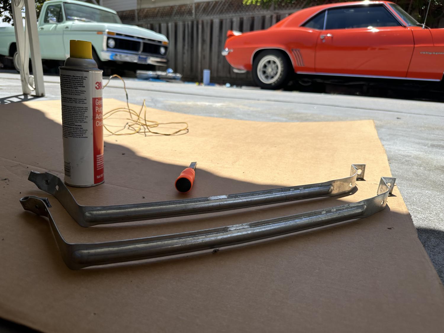

I can’t believe it has been almost a year since I last posted. We had a baby boy, and the fuel pump died, and something about those two events conspired to pause things for a bit
I wanted to take the opportunity of replacing the pump to snowball the job into going through the whole fuel system… so pulled the tank, cleaned everything, replaced all of the hardware, cleaned and painted the straps satin black, and replaced the rubber fuel lines. Lloyd very generously gave me some spare fuel hoses he had stamped, and my goodness do they look great. I’ve got some square-tang original fuel clamps on the way so pay no mind to the repro round-ended ones on there now.
I have yet to find an original dated fuel pump so for now I’m running a Carter M4685 from Summit, rated for 7 psi. To keep the crank-driven pushrod up and ready for the pump arm to slide in, I used the technique of running one of the pump mount bolts into that nearby threaded hole that then lightly presses against the rod (too tight and it could bend the rod so went easy on it). Worked well (I tried just using grease and couldn’t get that to work at all). On the tank grounding strap, I used some spare fuel line and some tape to simulate the strap retention setup to protect the wire from the tank strap. I also removed the padding that the restoring owner had used between the tank straps and the tank, as originally there would have been no such padding. Looks sharp now.
All put back together, the car fired right up and is running great again. Tuning improvements from last year combined with a new pump have proved to be a great combo. Back to life! More photos to follow.

Looks good Matt! When you get a chance, paint the back side of your spare wheel a satin black. The factory used a black primer on the Rally Wheels. Try and find some original green 3/8 fuel line clamps that have the flat crimp tips or grind down the rounded tips, so they look flat. They just can't repop stuff like the original for some reason.
