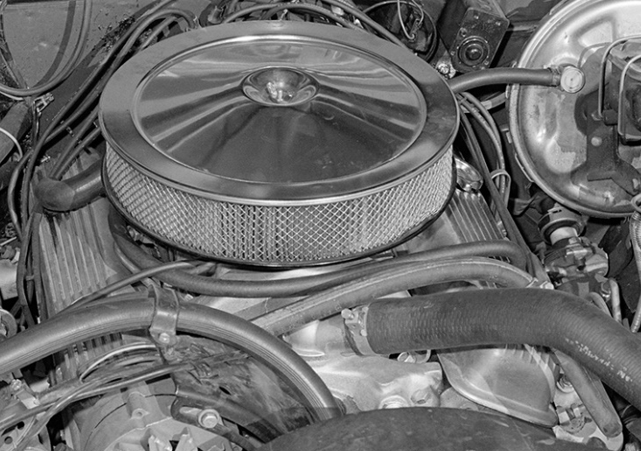

Engine bay photo from the January '69 Hot Rod magazine. Car still exists; was final assembled on or about September 30, 1968.
I doubt there was a first/second design. Both were production parts; workers used whatever was available.

Just an FYI,. A 2D survivor car Z28 I owned had the early style left smog tube. I believe it's a valid data point because this car was never modified and the original owner still owned until 2006/2008. Exhaust manifold/smog had never been removed, however normal maintenance items were replaced as needed.

I've always believed the Drivers side Hockey stick tube was the first design used on the earlier assemblies,and the middle connection tube was the second design used on later assemblies.When exactly that change occurred,I don't know,but I believe your early camaro should have the first design Hockey stick tube before you asked this question,and Jerrys book,Williams photo and Steves photo support this.
Steve,I see the drivers side second design on your 2D camaro.

Correct the hockey stick is the first design, and what you are referring to as second design was in fact used in 1968 and again reintroduced in Feb of 69. I previously referred to as earlier because it was used in 1968 but in 69 it was reintroduced and referred to as 2nd design in the book you reference.

Hockey stick style would be correct up until Feb of 69.
