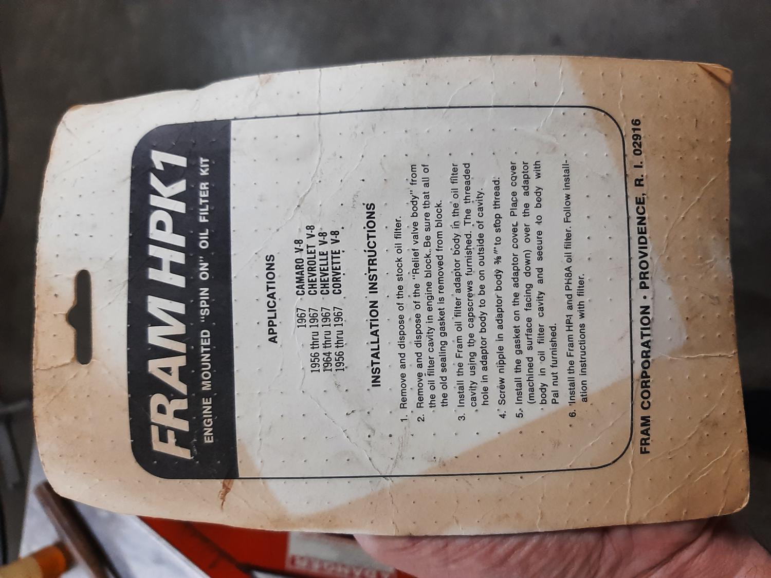

With the way people collect old parts in the package, I was wondering if this is worth selling as is or should I just tear it open and use it? It's pre barcode, but I don't know how old it is. If I sell this one I'm going to have to buy another newer one. I believe the writing will rub off.

Just put the damn thing on for crying out loud. ��*♂️��������. Pretty sure it much higher quality by today’s standards.

----A dab of lacquer thinner will do the job on the printing....Bill S

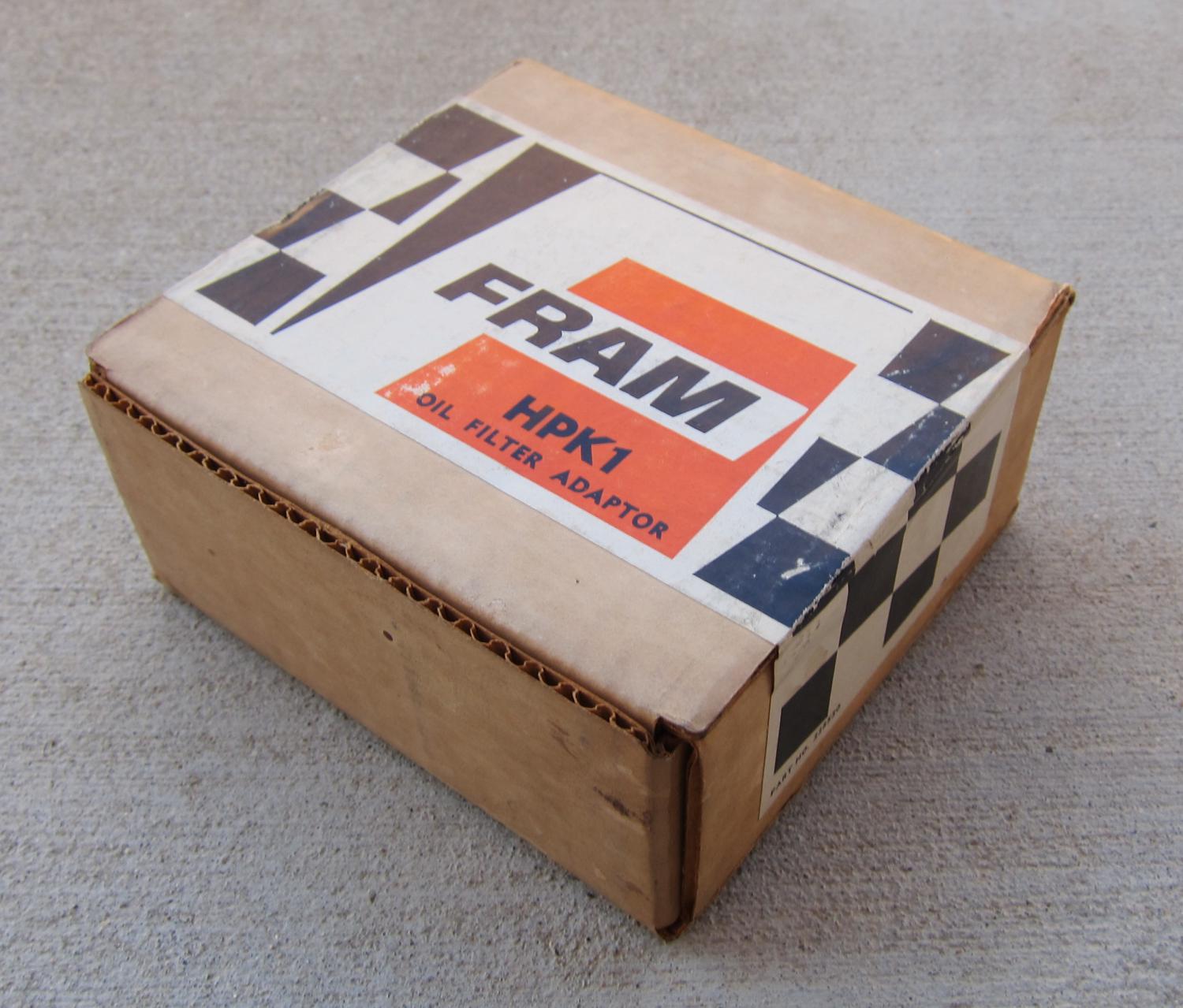

The original packaging from the late '60s looked like this, just in case anybody was wondering.

I would think the Taiwan sticker would put it into the late 80's, maybe early 90's.
Yea, but I would expect it to have a barcode on it by then. I think I'll just put it on dad's 327 and forget about it.
