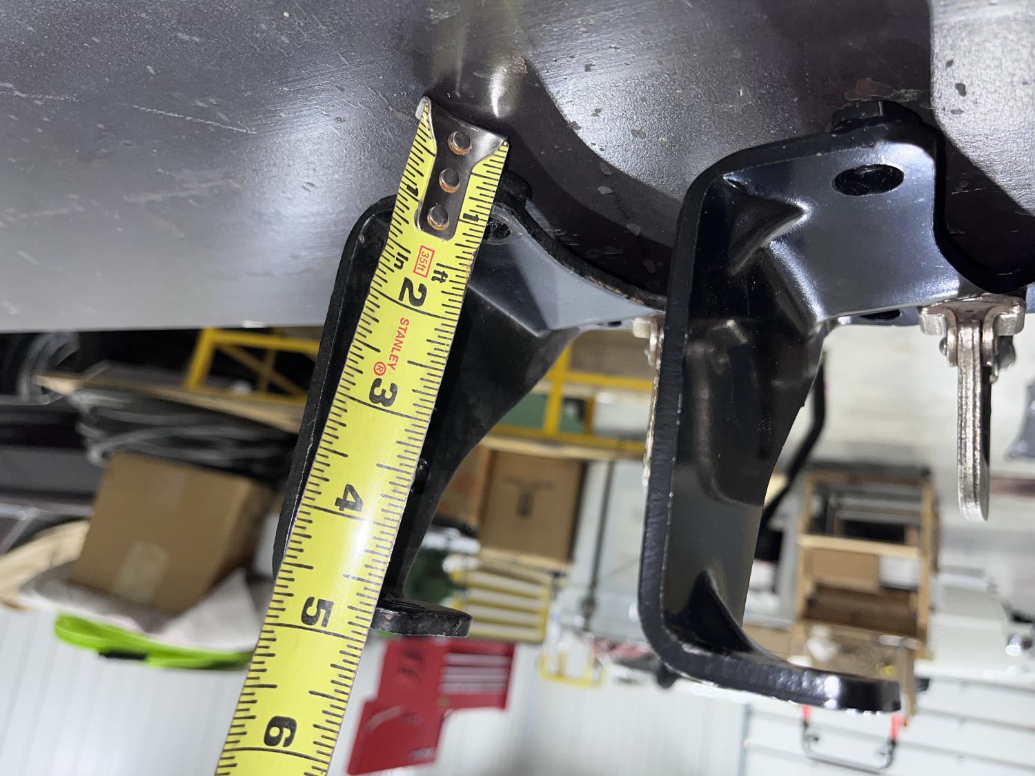

So I took my smog pump bracket off,
And matched up the off set to a new
One I just bought.
There’s approximately 3/16 difference,
The new one aligning the pump,
3/16 towards the block, witch is
The direction it needs to go.
I will mount the pump with the new
Bracket tomorrow, give u all another
Update. Dave

Default Original GM brkt. Installed
Here I have installed a good used GM
Smog brkt. The alignment is how it
Should be now.
