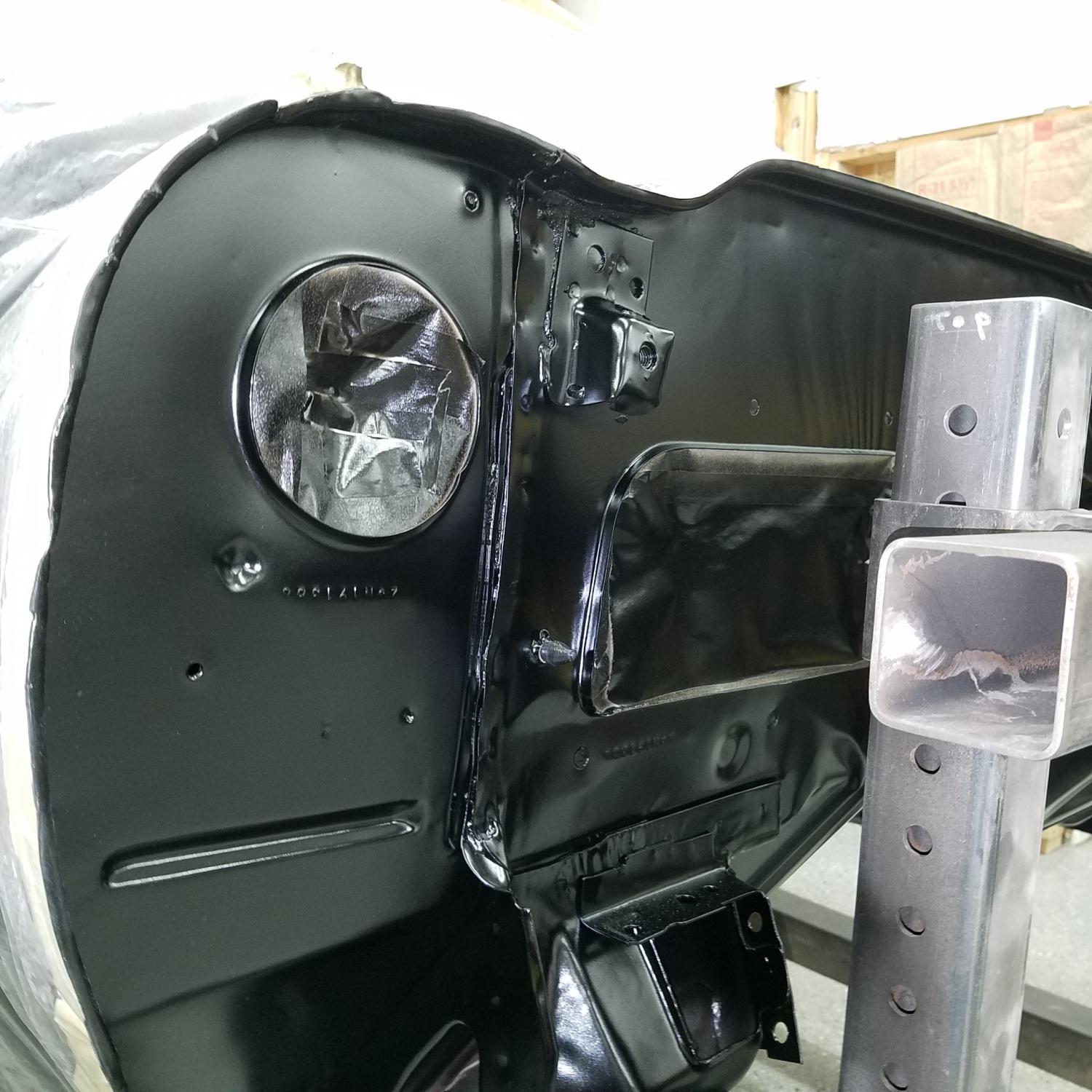

Here are pics of SPI Black Epoxy on a Camaro Underfloor
and pics of PPG Delfleet Essential mixed to the Semi Gloss
Formula on the Firewall (with SPI first on the sandblasted metal)
DAVE, My painter added ??? %% of Reducer to the SPI and its Flowed
Out Very Smooth............I'm not sure how he applied the Delfleet.....
