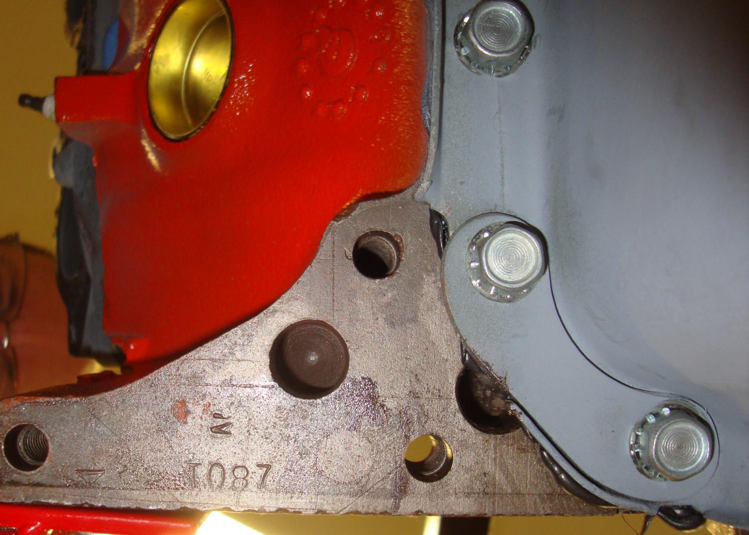

is there any way that the ce build stamping tell you the build date or is it just a sequence number

Look under the Starter Mounting Pad for the Assy Date stamped in the machined surface

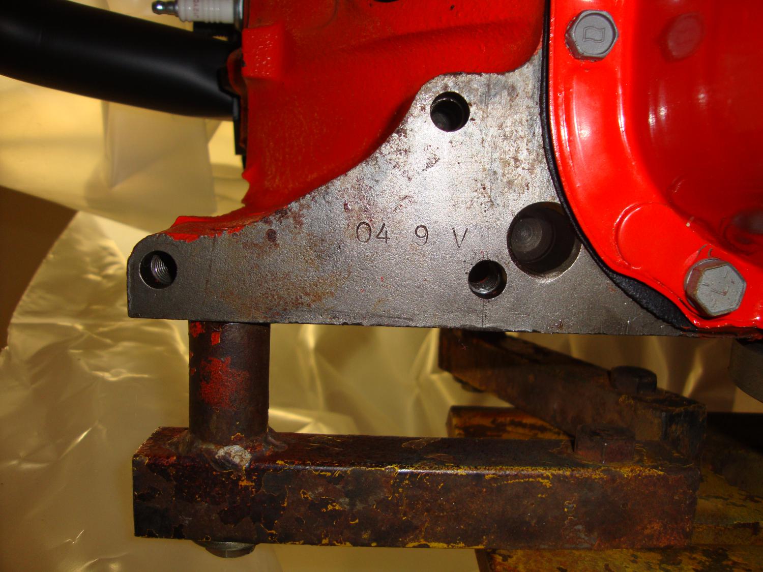

Default My 1969 CE 302 Warranty Motor for my 68Z
Example

Default My 1968 CE Motor (L78)
Sample of a BBC

And note the "V" and "T" indicating the engine plant.
