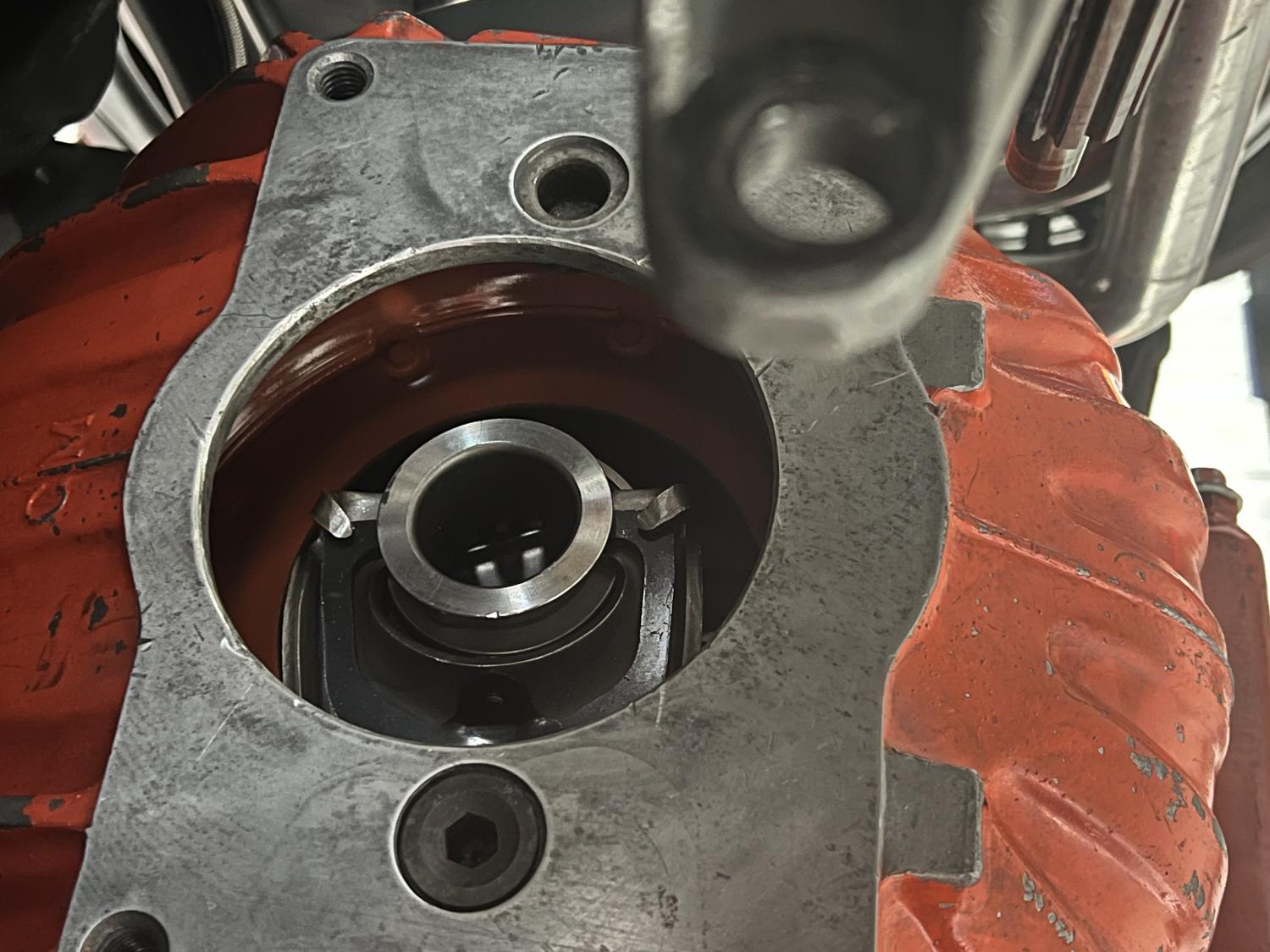

@L72Chevelle, I got the throw out bearing orientation fixed this afternoon. Sucked taking it apart but glad you pointed it out and it’s fixed correctly now.

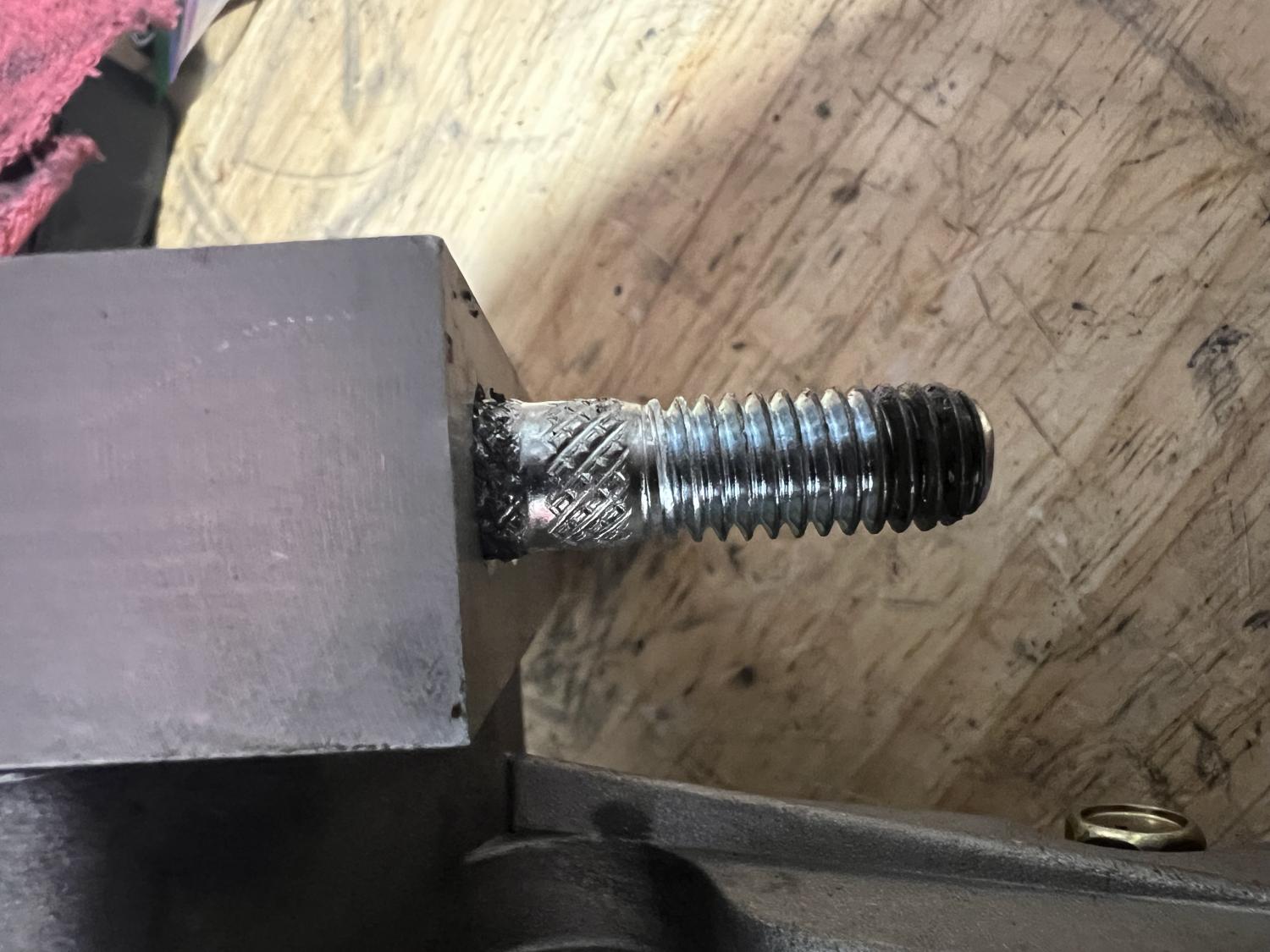

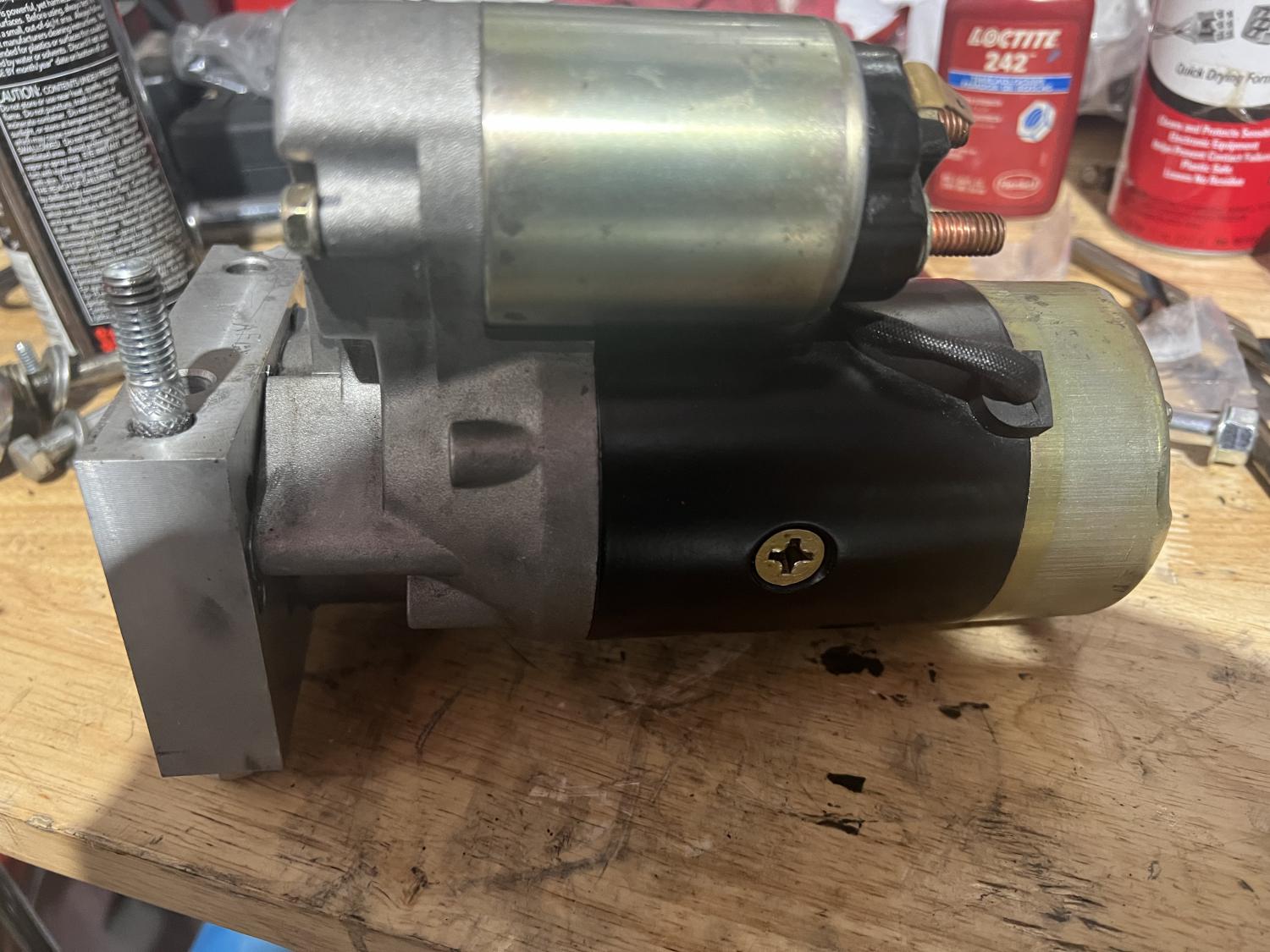

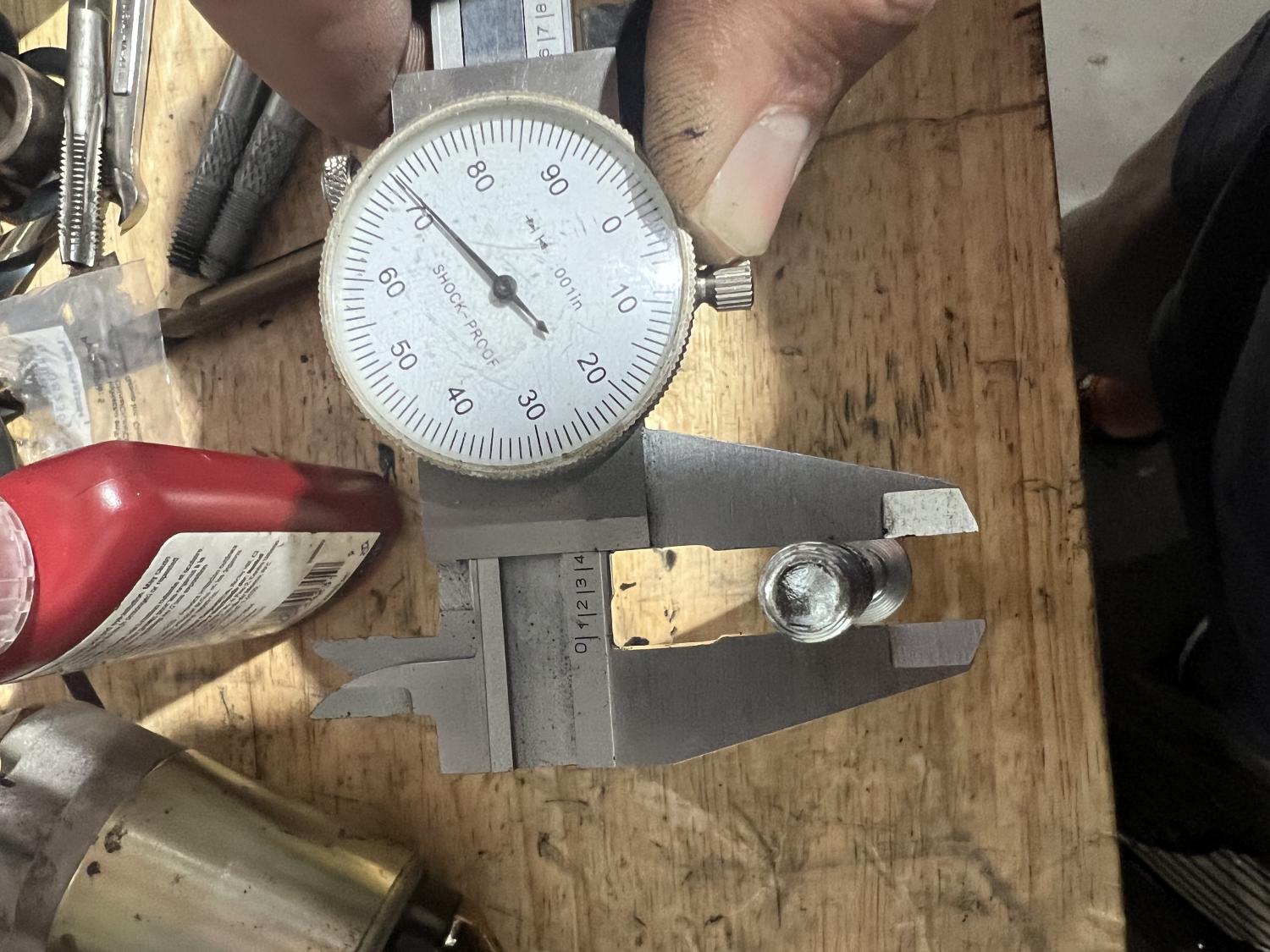

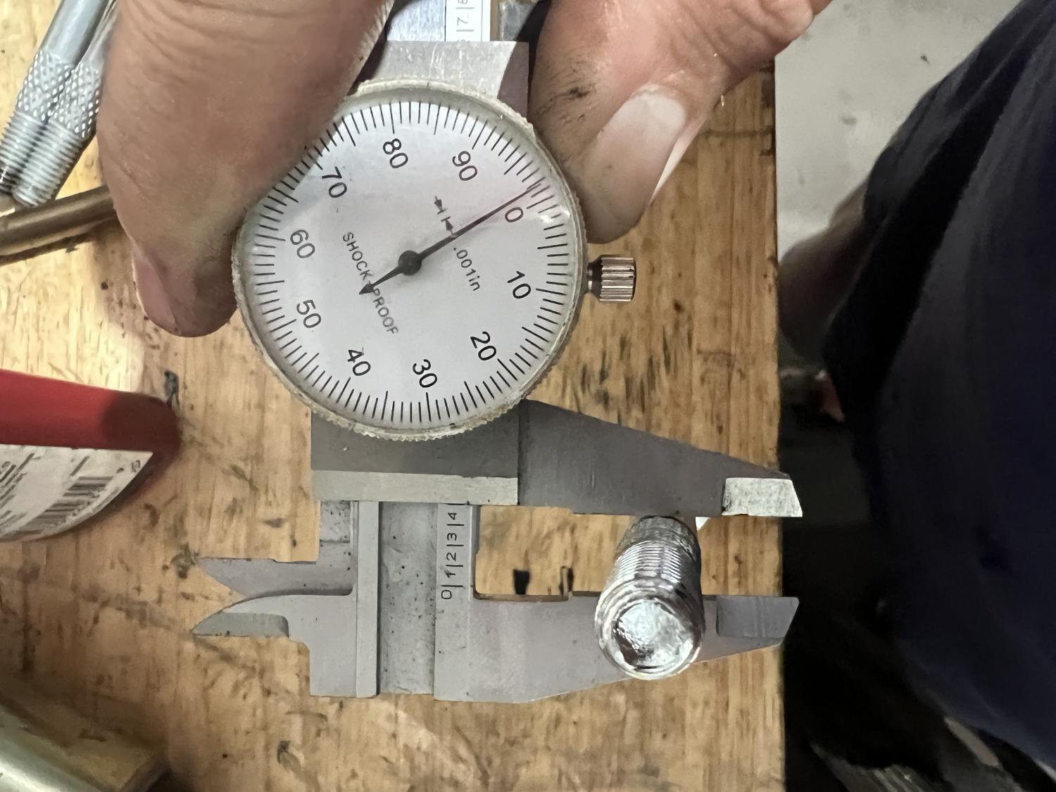

I'm tackling the starter bolt situation now and I've read that the GM 12338064/Dorman 678-107 bolt is the solution for "mini" starters since the bolt has a 10mm shank and knurl for the starter, and a smaller 3/8" knurl for the block so that it locates correctly. I will say that the knurling on the new bolt definitely provides a much tighter fit on the starter but, it appears that the bolt is sticking too far out of the starter, especially the larger knurling that engages the starter. I ran one of the bolts up by hand through the starter, into the block, and it stopped about 1/4"-5/16" before the machined face of the starter would contact the block. I do not want to damage the block by using the wrong bolt. I took some pictures of the bolt as it is installed in the starter and various other dimensions. Have any of you guys ran into this? Ideas? Should I junk this starter and get a GM type mini starter for a early 90s Corvette? It had a 153 tooth flywheel like my car does.
*under head bolt length- 4.31"
*knurl diameter on bolt for starter- .398"
*knurl diameter on bolt for block- .371"
*distance from machined face of starter to end of knurl for block engagement- .378"
*thickness of starter flange- 3.110"
