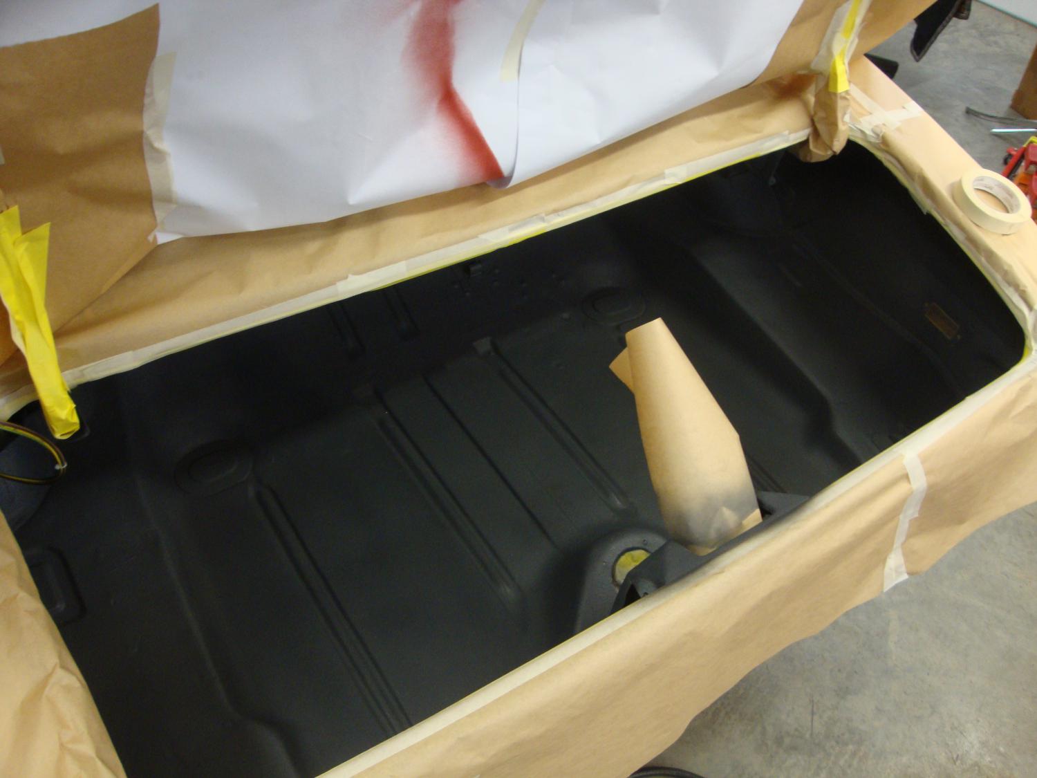

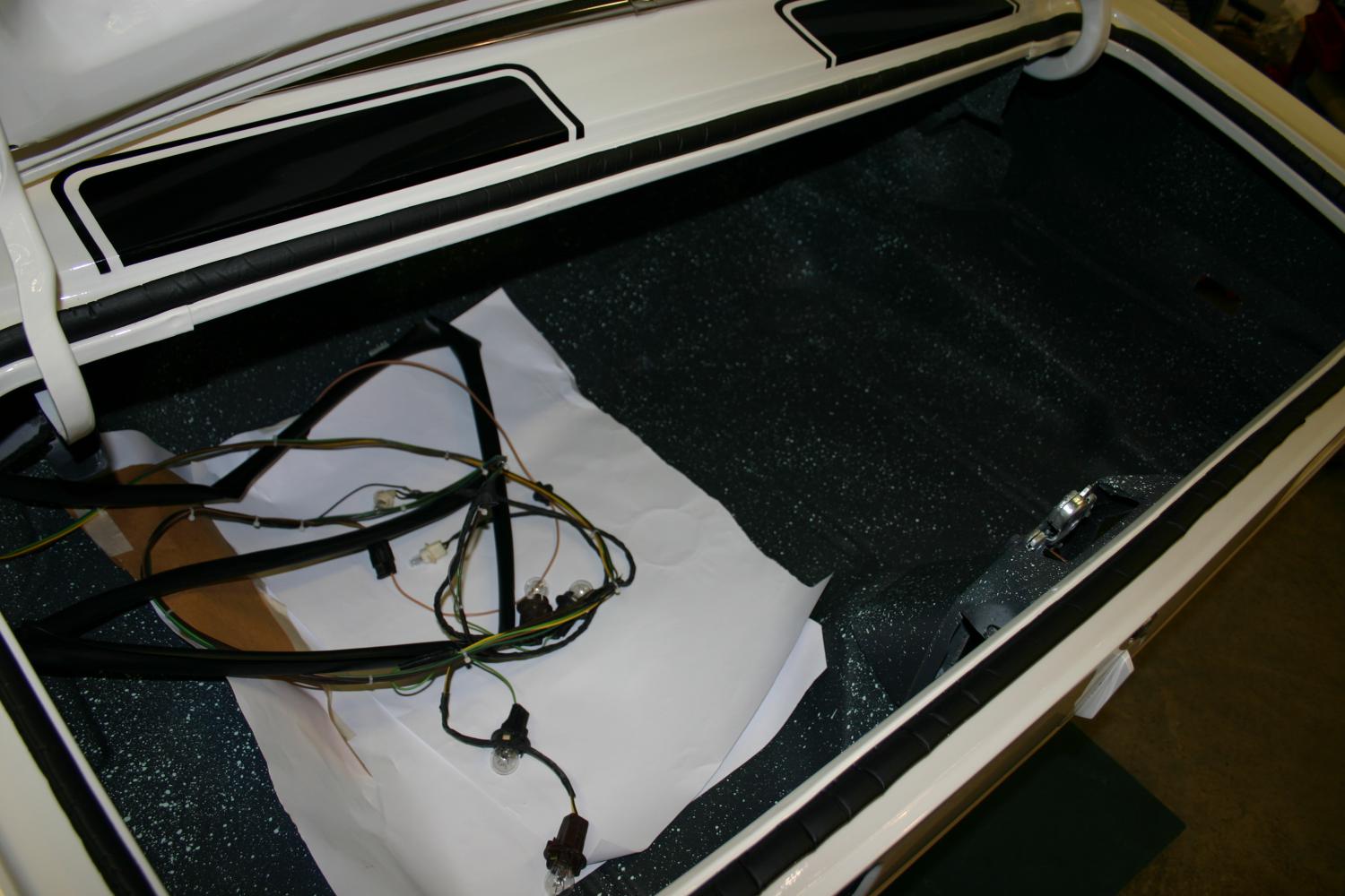

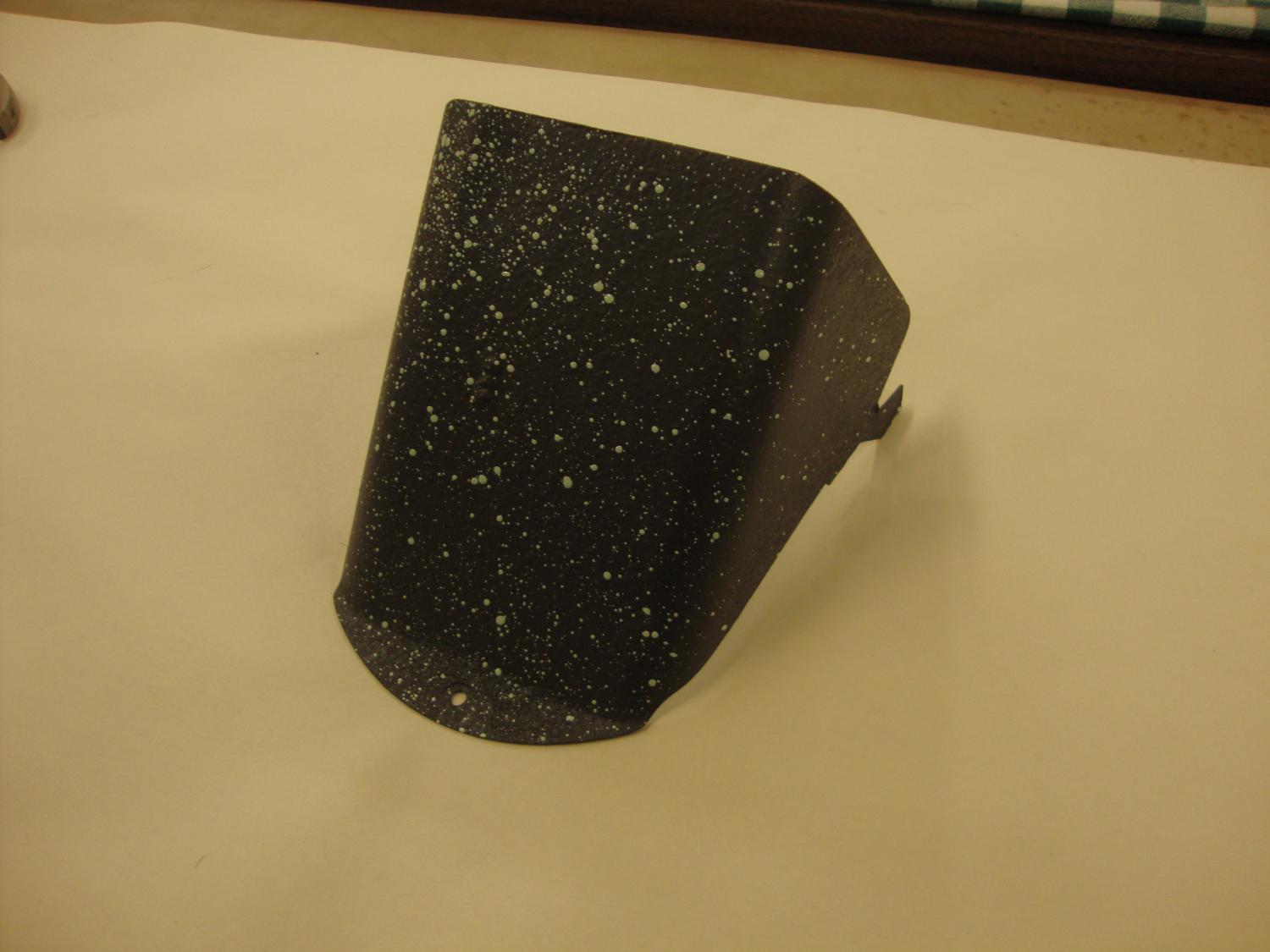

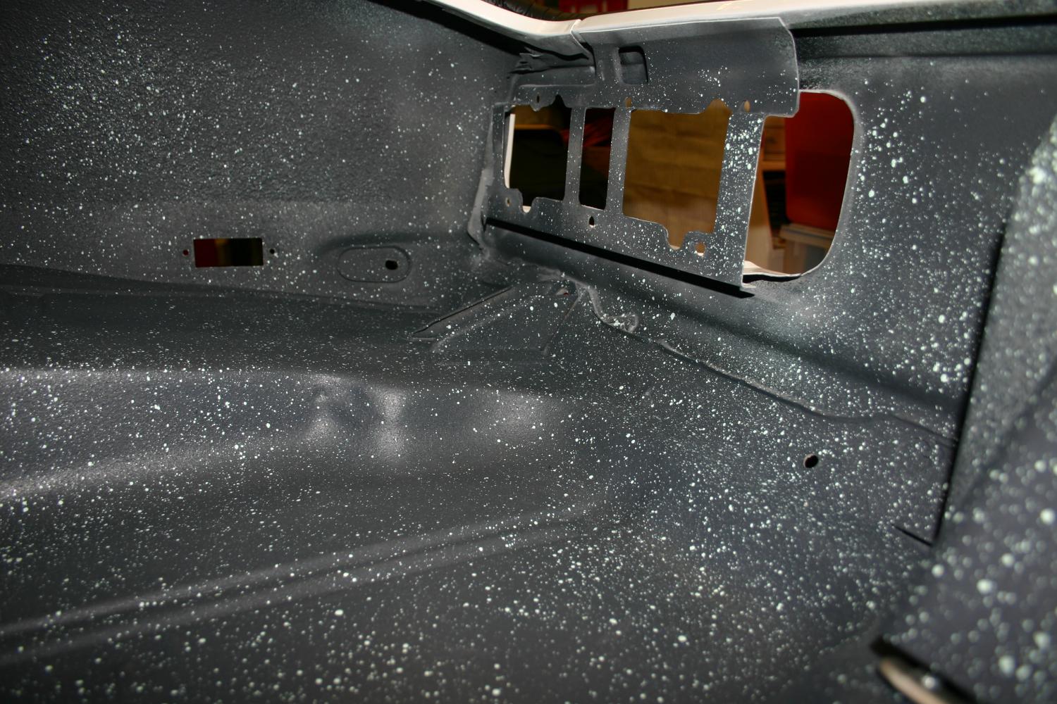

Anybody ever use this stuff? Any good?

I used that on my car. Send me a pm with your e-mail & I'll send you some high def pictures...Joe
