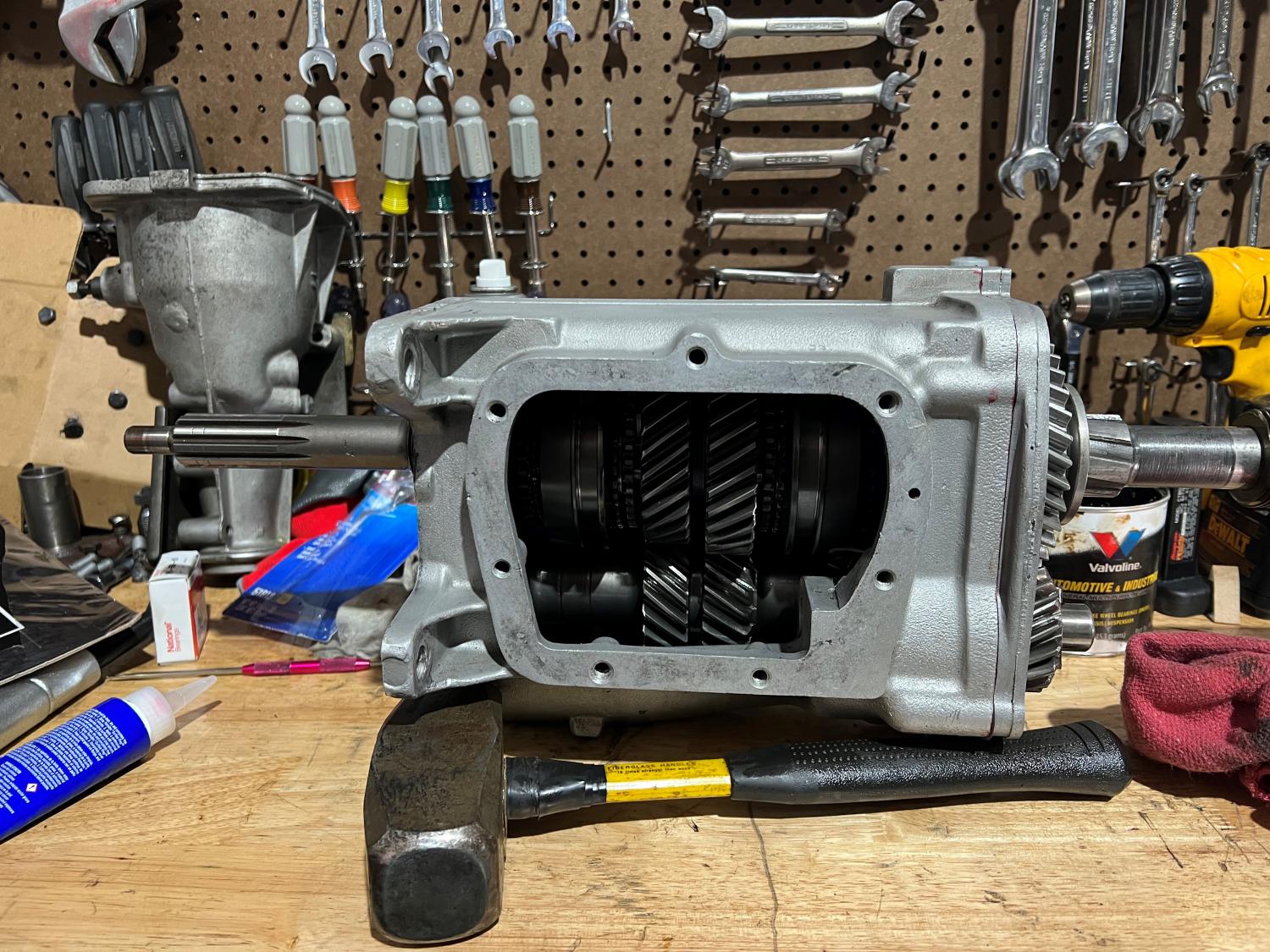

I’ve got an M20 Muncie in my 67 Camaro. I bought it completely rebuilt from a reputable builder and it’s got around 8-10k miles on it. It’s currently behind a 525 HP 406 small block. My problem is when I am in 3rd gear, and I decelerate while leaving the trans in gear, it pops out of gear. What would be causing this to happen? It’s very annoying and I want to fix it.

Look for wear on the little gear teeth or slider teeth that slide on to them to engage 3rd gear. I usually replace the slider and gear at the same time. It's not that bad of a job.

I suggest inspecting the bushings on the ends of the 3-4 rod for any wear or abnormality. Check the fastener at the shift shaft for any wear or looseness that allows the arm to move on the shaft. Also, that the adjustment is still correct. Components seat in and can be off enough that the 3rd gear slider may not be traveling far enough to fully engage the keys in the hub in the detent in the slider to help keep it engaged. Do the simple stuff first before looking at an internal cause.

With the, more complete, history on this, I'm beginning to think it may well be an internal issue. Steel bushings and new shifter eliminate a few of the possibilities. Could still be a loose arm, stop bolt nut loose and allowing the bolt to work it's way down or linkage out of adjustment, but getting worse with time/wear and with the same 3rd gear issue from the past, just seems to lead me to the hub/slider assembly, or another gear problem, now with the engagement cogs.
Talking with the builder may give insight, if he can recall, or have a record of exactly what he did when the gear was replaced.
Pulling the side cover will give a visual of the gear cogs, but they are not the primary component of keeping the slider engaged. Yes good cogs that aren't all rounded and chipped do help, but the keys (dogs to many) in the hub have that task as well as the fork springs and levers in the cover. The keys are under tension from a large "C" spring under them and between the keys being worn from use and the springs occasionally breaking, they are the main reason for popping out of gear. Broken springs and worn levers in the cover can add to the problem.
If you do remove the trans and side cover, moving the slider to second gear should have a slight click sound and the keys pulling the slider into position the last slight bit. You'll probably have to move it a few times to get the syncro ring and gear cogs lined up perfectly to "feel" the keys engaging. If you don't feel/hear the same positive engagement going into 3rd, my bet would be on the hub/slider assembly being an used component that is now worn enough to not hold the slider in place tightly enough.
