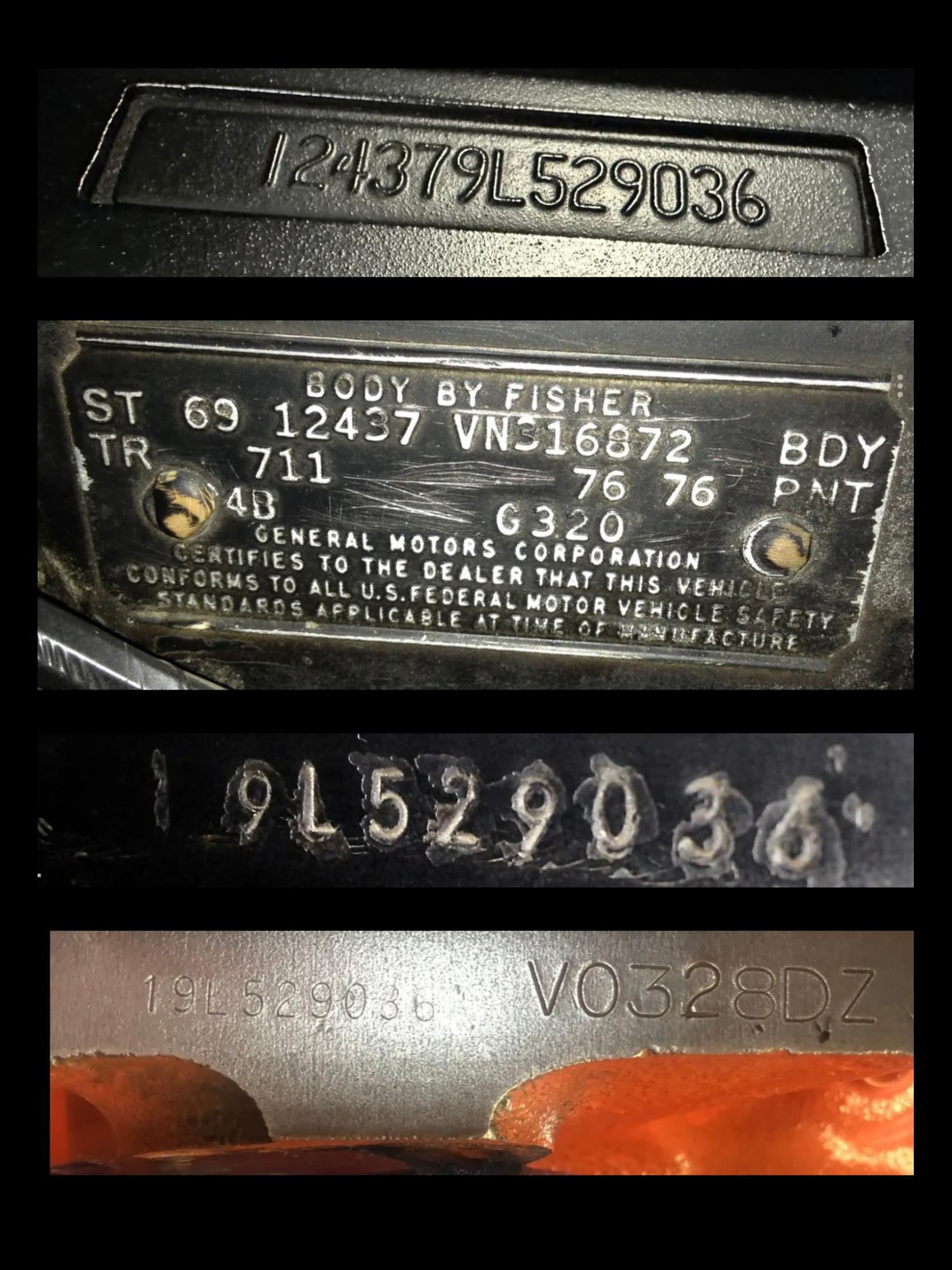

What do you guys think of the block stamp? Is it my imagination or is there something under the vin? My block assembly is 2 weeks before and I have the short tailed Z that is different than this. I think my 3 is different also.

Posts: 2,506
Did they use the same gang holder to stamp the block and trans.? If so, those VIN stamps look vastly different block v. trans, may be wrong here...

I have several other V0328DZ pad stamps that compare well. Block and trans VIN stamping done at different stations in assembly.
Don't know about that distributor stamping though. Need a better pic.

----That pad has great broach marks and not one criss-crossed broach scratch (for want of a better term) . The only way I can see this being a restamp is if the block was never stamped from the factory. Very unkikely!....Bill S
You could fill a library with what I DON'T know about Camaros (though a DY 69 Z is on my bucket list--timing is all wrong here), but I think any Corvette guy would be proud of that pad. I would bet the farm those broach marks are factory.
Slightly off topic.... A pad (below) came up (in a 300 horse 63) on CF recently that had very good broaching, probably adequate to pass judging. There is some subtle criss-crossing on the leading edge, but the surface looks good in other areas. Could have been due to someone cleaning it off with sandpaper or the like. Most people called it real. I was the first to call restamp, then a couple other highly-knowledgeable people agreed. Coincidentally it was the same engine build date as my original 63 (known original engine), so I compared the two and the characters were very different. The owner concluded it to be a restamp after the discussion.
I think you can get to 80% certainty based on the pad surface, but true validation requires a library of known-good stamps to compare characters. That's why Al Grenning is so valuable to us Corvette weirdos.
When people are going to such lengths to stamp a 300 horsepower small block, it's underscores how much of a jungle it is out there...

What does anyone think of the seller's statement that the rear axle assembly must be non-original because the stamped date on the axle tube is four days after the production date shown on the NCRS paperwork?

NCRS says production date was 4-14-69, but the rear is dated 4-18-69. Judging by the rust on it, it may be out of a midwest car. Trans partial VIN stamping doesnt look right.
