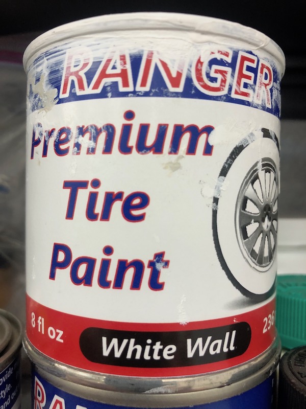

Guys what is the best way to clean raised white letter tires? I have tried everything. I heard tires release oils on the white letters that continue to cause a brownish stain. Very frustrating to keep these clean. Any input other than white letter cleaners that are on the market.

From what i read the oils release from the rubber and surface on the white letters on the tires. Heard a sealer of some sort to stop these oils bleeding thru. I tried the tire paint pen, did not like that at all.
