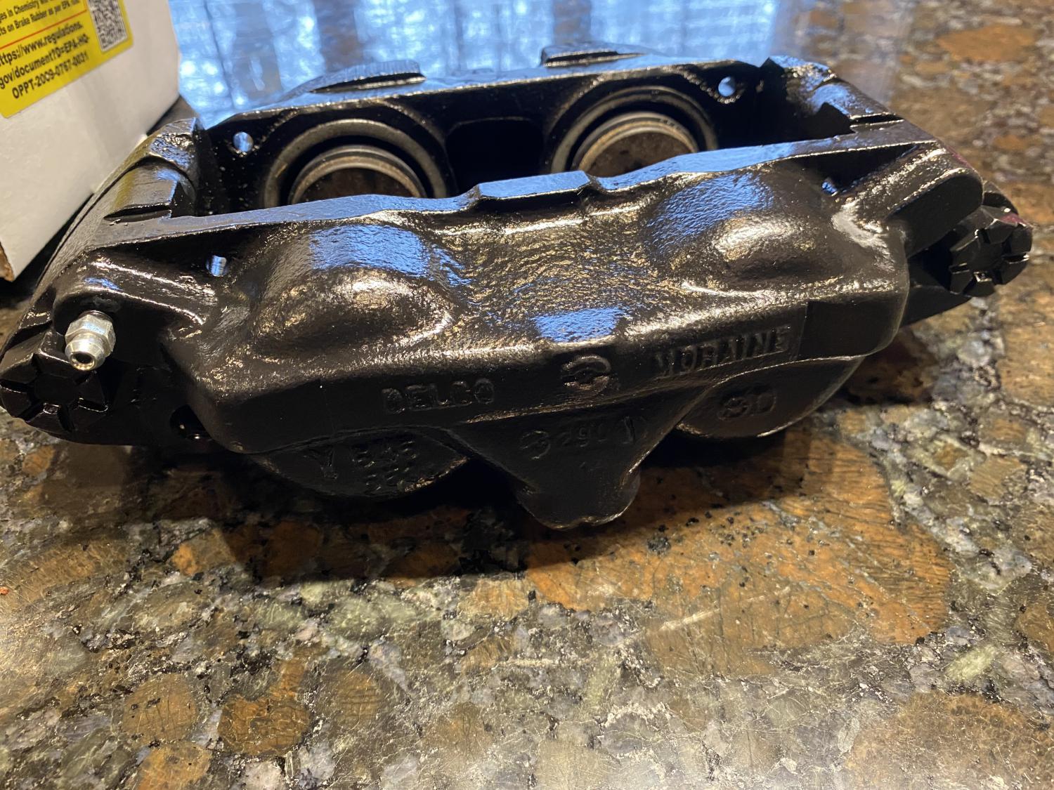

Who rebuilds/restores brake calipers? I need the 4 piston calipers for my Beaumont rebuilt. I'm having a hard time just finding rebuild kits for the 4 piston ones.
Thank you, James
