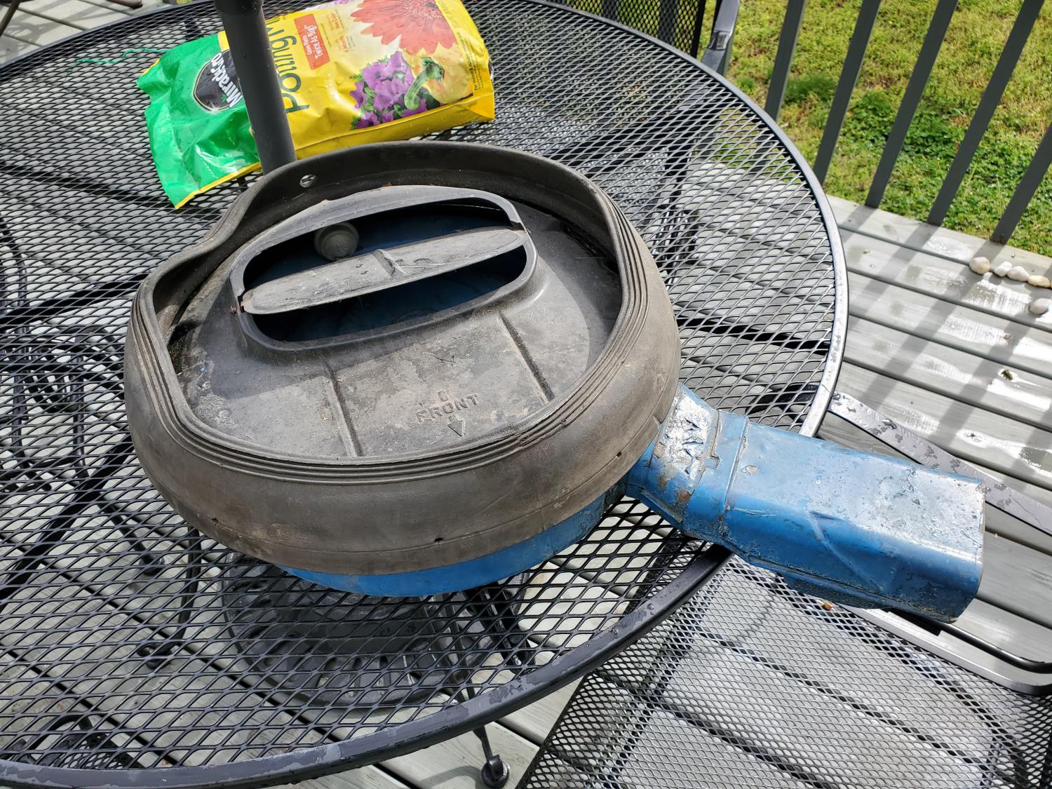

picked this up, can someone id it?
thanks

Looks like a Ford Cobra Jet. Not sure which one though.

Looks close but would need a deeper dive to determine exactly what it is.
https://www.428cobrajet.org/id-air-cleaner-68

Seems like it's for a 429 engine due to the snorkel taking a step down but I'm not a Ford expert.

its for a ram air not not SHAKER, so its 68 or 67 mustang, 68 or 69 torino, Im guessing. With the stop down it kinda reminds me of the 69-70 boss 429

To me, the rubber seal in your picture looks like this one for a 1969 Torino/Cyclone…..?
https://www.ebay.com/itm/15525760168...mis&media=COPY

It appears to be correct for a 1969 Ranchero with a 428 CJ…..maybe others? But the dip in the snorkel gives it away.
http://blog.dearbornclassics.com/196...428-cobra-jet/

yup, there it is, great detective work!, thanks

It might also work for a 68 1/2 Mustang Cobra Jet.
