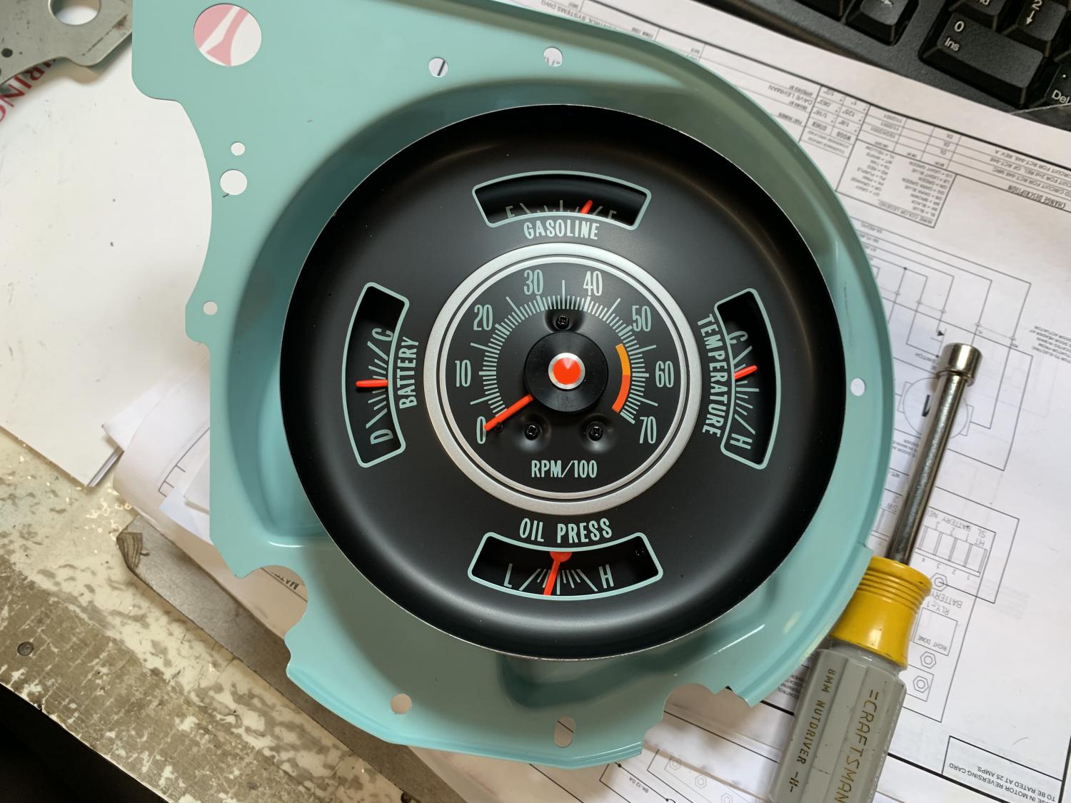

I've noticed that in the NEW gauge cluster - the tach red line does not match the red line in the original gauge cluster
Were some of these red lines different on the original clusters - early vs late - or is this just something with the re-pops
