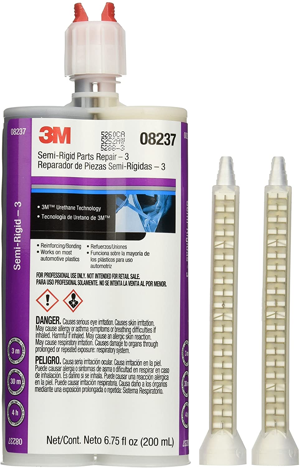

I then used the 3M 08327 Semi-Rigid Parts Repair epoxy and put down a bead in the same areas where the old green glue was. I then placed the headliner panel on it and covered it with some old towels and around 45 pounds of weights to press it in place. The 08327 cures in around 5 minutes so you have to work rapidly in laying down the glue.

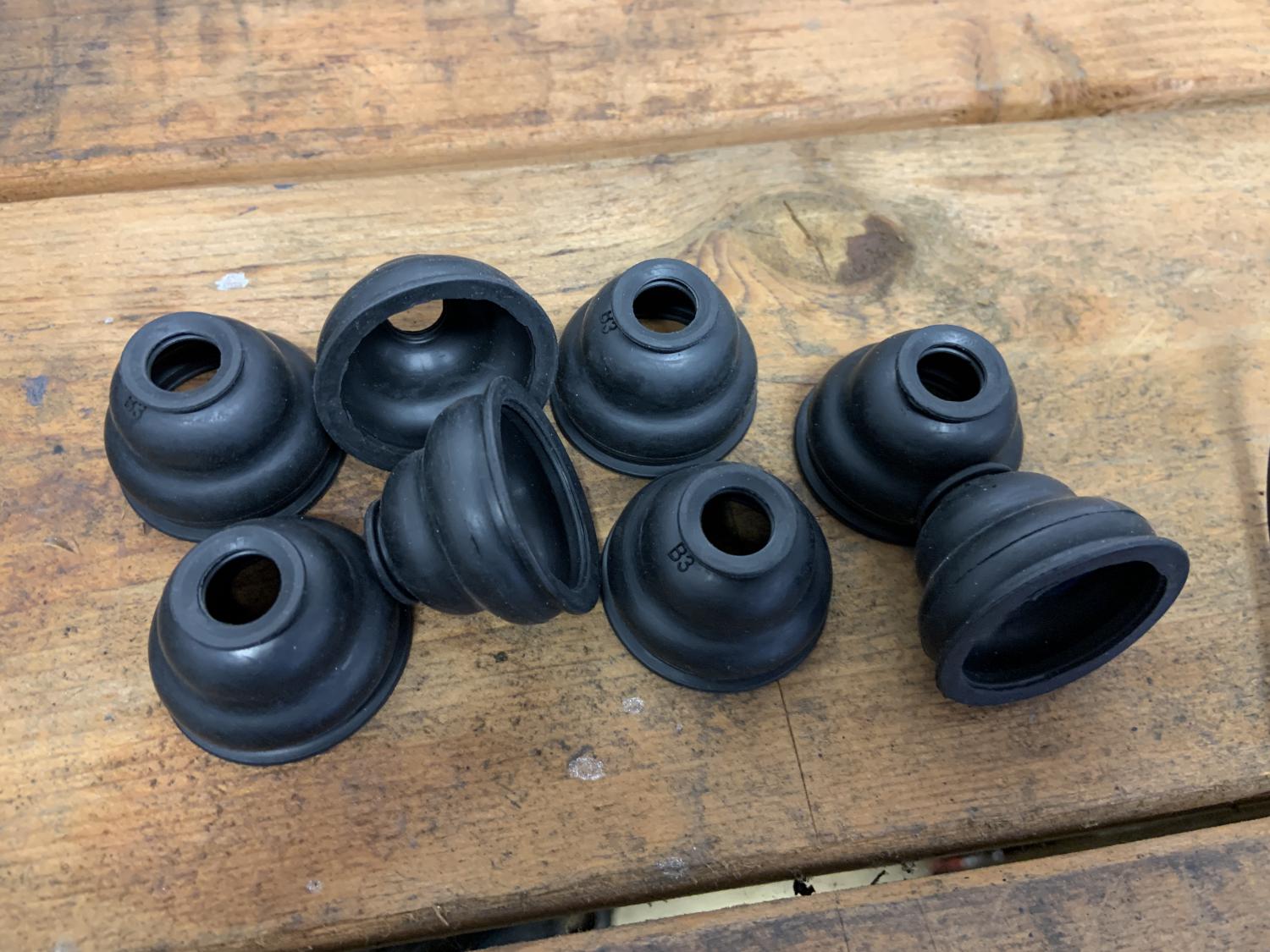

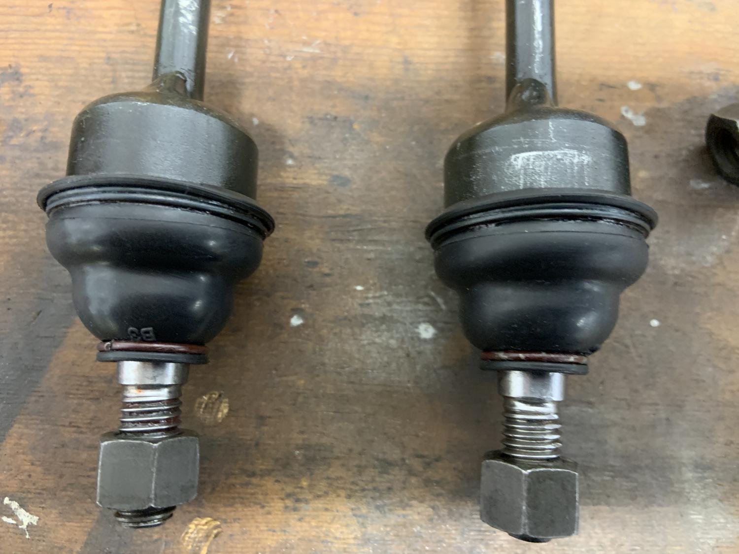

Since she is up on jackstands I am still "mission creeping". I was greasing all the ball joints and tie rod ends when I noticed that all the sway bar link rubber boots have turned to rubble. They were a clear poly material originally and have totally decomposed after 29 years. Don't even get me started on what a new set of sway bar links go for if you could even locate an NOS set of the unique 1992-95 links - try around $300 each!!! And no one makes replacements.
There is some Viper parts place out west that advertises a new set of boots for $200 !!! (The dreaded Viper tax) Seriously guys? You can just measure the flanges and then shop for replacement boots on the net.
Before I started measuring and searching someone recommended I give Tator's Garage a call http://www.tatorsdodge.com/
https://www.youtube.com/watch?v=mJwL...el=LewisboroTV
So I used some ball joint pullers and got the links off today. They were all in perfect shape other than the boots. I was able to make contact with Chuck Tator at Tator's Garage last night. (they were formerly known as Tator's Dodge, est in 1908 and they were the oldest Dodge dealer in the world, when Mopar decided to cancel their franchise during the bloodbath of 2008 when they killed off 1/3 of their dealership franchises because they were not multi-branded.) They were also one of the largest Viper dealers for Dodge back in the day.
I left a message for Chuck and he called me back at 8:30 this morning and said he was mailing out the new set of boots for $40 and needed my address. I then asked if he was ready for my credit card info. He replied: "I don't do credit cards - the bank takes too much money. I just send out the parts and an invoice and you can send me a check when they come in." He even encloses a stamped, self addressed return envelope.
Holy Cow! It's like I'm back in olden times.

One day later, they arrived from Tator! :-)
$45.50 for the boot set including a stamped, self-addressed envelope for payment. I rounded up and sent him a check for $50 just for the helluvit.
Easy install, The small ring clips go on first and are easy to slid over the flange. You then grease up the joint and slip the seal over until the big flange goes over the collar in the link. Then you gently wrap the large spring clip around while holding the end in place. Takes some practice but by the 8th one I could do it in around 15 seconds.
