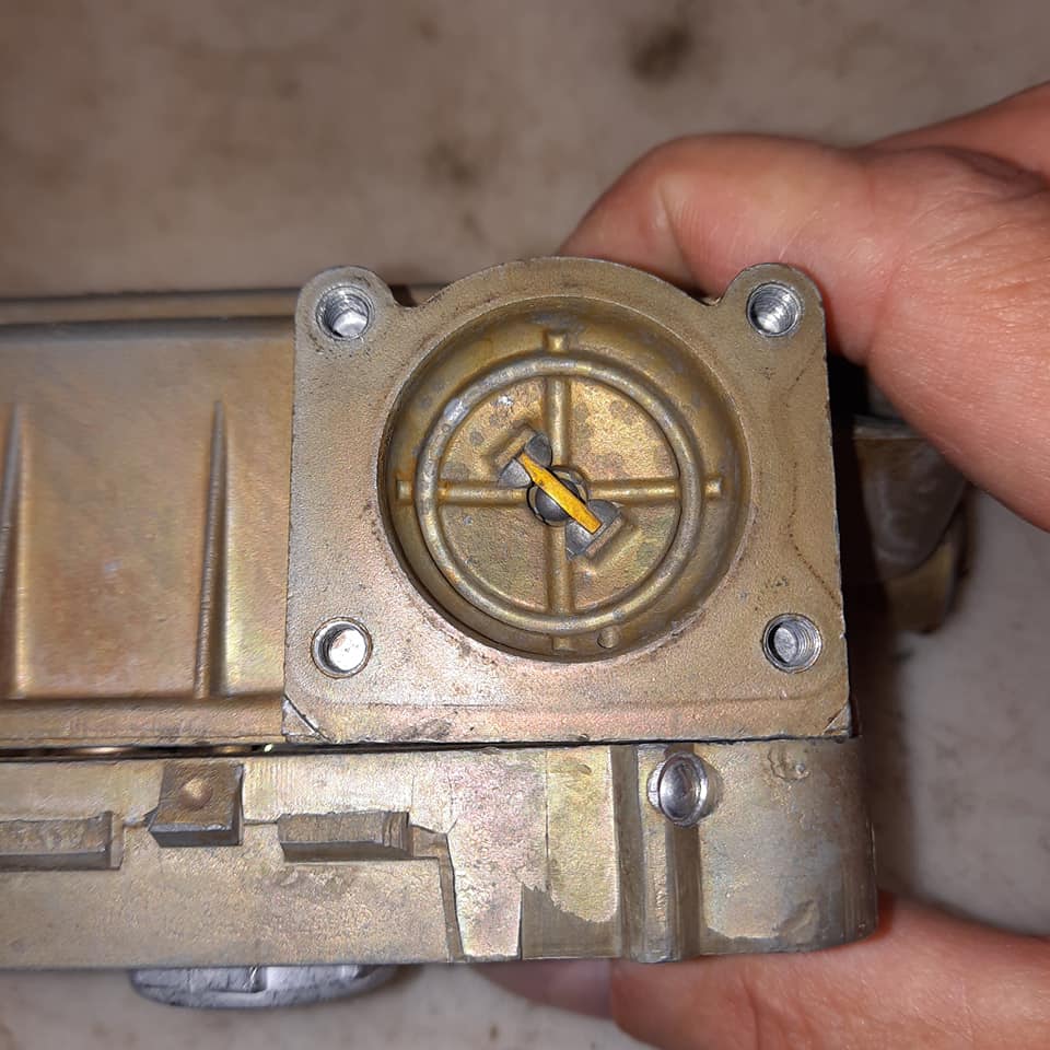

Not sure if this is the right place for this but I could not find a more suitable location, so here goes.
My bone stock '69 302 has been giving me fits on throttle response changes and I thought I would pose it to the crowd to see if I might find another avenue to search down.
I have played and played with squirters and cams and I have it pretty close now but still not as good as I feel it could be.
My problem is that when I start the car cold, I have the most wicked throttle response you could imagine. I have chambered exhaust and in neutral when I snap the throttle it reacts so quickly that it literally sounds like an explosion out of the tailpipes. The issue arises after the engine gets to full operating temp. As it gradually warms up the response gets lazier until at full temp it has lost its snap. Still good clean response but so different than when it is cold.
I am running full time vacuum at idle to the distributor. All in at about 6 inches. The can adds about 16 degrees. About 16 degrees of advance at the crank and about 23 degrees mechanical. The car runs great, but that cold engine response just has me wanting more at operating temps. Cooler weather helps as in the late fall it hangs on a little longer, but summer driving causes it to dissipate quickly.
My thinking is that the warmer air and engine is causing the mixture to get richer. I have tried to take out some pump shot by adjusting the spring on the pump lever and that has helped, but I feel it still could be better. Any thoughts and is anyone else experiencing this or is this just the way it goes?
Thanks for any ideas!

Thanks for the replies. My balancer has not slipped. On the dyno it made the most power at 39 degrees total. I checked the stats, and the initial is 18 and the mechanical is at 21. Again, I am running full time vacuum advance of 16 degrees all in at idle. I already am on the threshold of running too much initial as any more seems to become a problem for the starter.
The mixture screws are very responsive and are set about 5/8-3/4 turns out. That seems to be maximum vacuum (11 +/-) and rpm. I have the idle set at about 950-975.
Again, the car runs great, I just am so thrilled about the cold responsiveness that the letdown when warmed up is frustrating. If I had not ever experienced how crisp it is cold, I probably would not think anything of it. I just know that if it can be that crisp when it is cold, I should be able to get it that way when warm.
Could it be a manifold that is too warm? Perhaps open crossovers causing excess heat from the exhaust?
Thanks again!

One more thing. I currently have a 31 squirter and the blue cam for the accelerator pump circuit. 30cc pump. I know that 28 is regarded as the typical squirter to use. I am of the thinking that a higher number squirter will limit the amount of time the shot moves through the cycle, But I have even gotten decent results with a 21 squirter. It just seems to have a small initial void with that and the 25. I have found that backing out the adjusting screw to limit the amount of fuel the pump can deliver has made some strides. I have been careful to be sure there is still 15 thousandths extra travel on the lever. I have also run the white cam with similar results. Always in the number one position. There are conflicting reports on the accuracy of the Holley pump cam charts particularly of the blue cam. I have seen the blue cam charted in two totally opposite curves.
It just seems to me to be a heat related issue. The car is not running hot, though.
