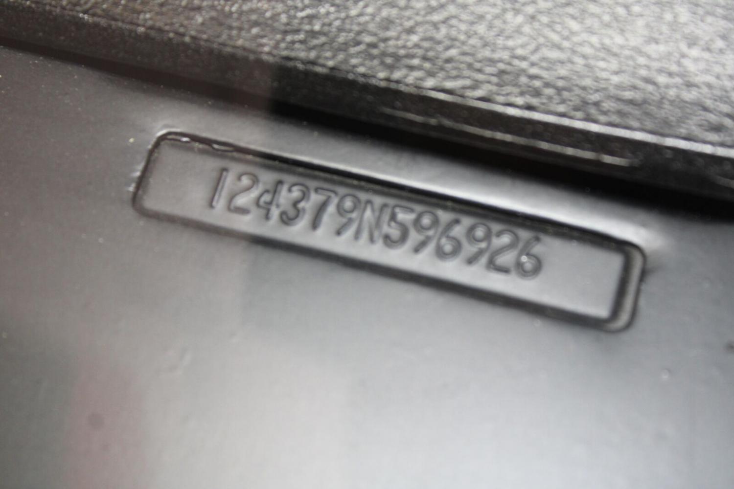

https://www.ebay.com/itm/255736846768
124379N596926
That VIN was final assembled at Norwood OH on or about February 12, 1969. Has an 01C/I371 Van Nuys CA body tag. Hidden VIN is 9L516898.
No question about this one; good pics of both tags. This car was on BAT last year; I questioned it. BAT pulled the listing. None of this is mentioned in the current ebay ad.

That car has a serious identity crisis.
