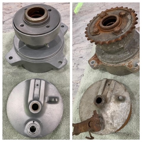

Vapor blasting is the best aluminum cleaning I’ve seen. Steel shot would work the surface way too much IMO

I ve read about the MIRACLE of Vapor Blasting but havent experienced it myself.....
I'm "thinking" that sand cast parts were run thru shot blasters (Wheel-A-Brator) when they were 1st mfg.........and I believe that short (under 5 minutes) periods in a shot blaster would make a sand cast manifold look like NEW again.........We shall see !!!!!!

What is vapor blasting?

https://www.raptorblaster.com/what-i...-wet-blasting/
