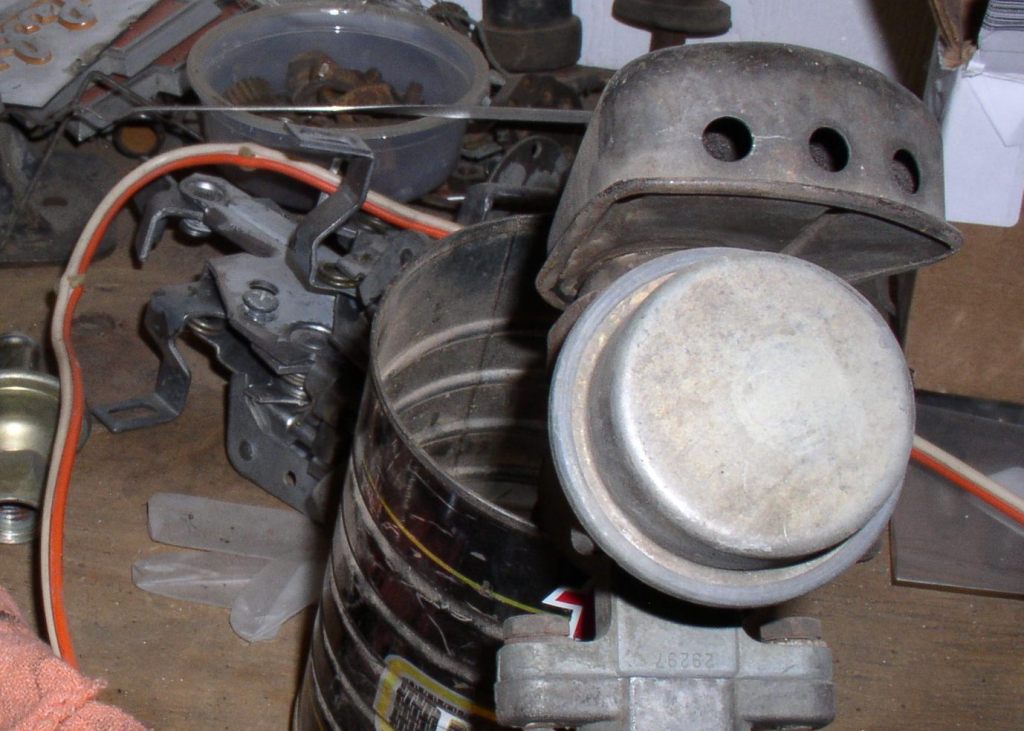

This is my original pump & diverter valve before restoration. I restored it back to how it was original. It had a sticker....Joe

I did mine as I found it. Car had low mileage in 1981 & I didn't have to find any parts for my smog system. It was all there. I did a post on CRG to see what they know....Joe

The best I could suggest for your car is to find a known original from the same plant as your, built at approx the same time as yours. Maybe that plant had lots of inventory & they were stamped. By Aug 1969 Norwood didn't realize they had to build more 1969 Camaros & their inventory could've been different. Just thoughts. What was correct on mine doesn't mean it would be correct on yours. Research is one of the big things of doing these cars.....Joe
