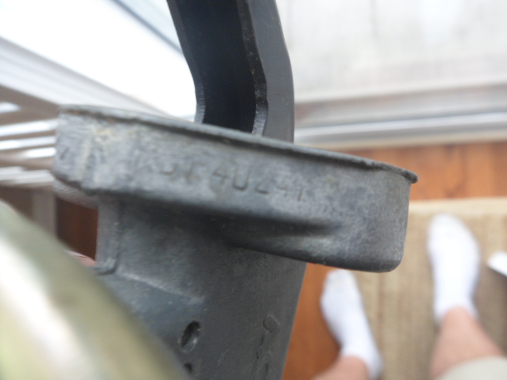

HI box says 40727 is a big block chev 1969 but pump has 40247 hard to read can any tell me what this is off Thanks

40247 is for 66/67 366 Trucks as Rick's reply a few years back but you had the box then?
https://www.yenko.net/forum/showthread.php?p=1007377
The 40727 is in demand, any chance you mixed up the boxes and still have it?
