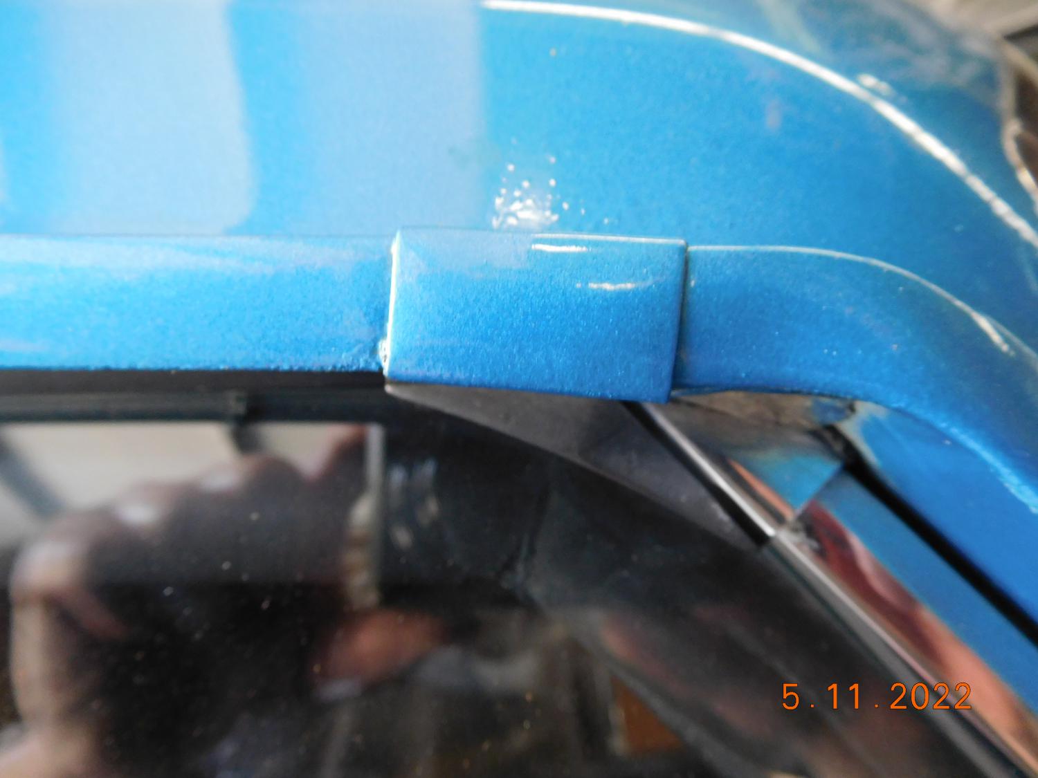

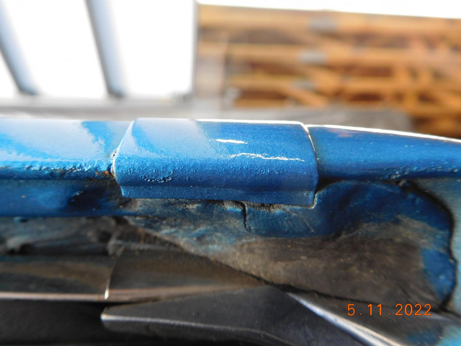

I had no idea I was missing this piece until the MCACN judges pointed it out to me. So I sourced a pair and painted them to match the car and now want to consult the experts here to make sure I get these on the right direction. Which way do they go? Flat side in the drip rail gutter or on the outside? Also, any tips on getting these on without damaging the paint on the car? Front to back, I assume I put the gutter seam in the middle of the clip, correct?

They should be in more a "C" shape. Yours look closer to a "U" shape. The go on kind of like adding drip rail moldings except looser. Mine didn't want to tighten up so the paint shop used some panel adhesive to keep them in place. You will probably have to repaint them after attaching them. The wavey side goes under the drip rail.....Joe

Anyone got a few pics of one installed? would like to see both the top and bottom side of drip rail viewpoints. Held mine up this morning and the fit is very loose.

I can get a pic of mine tomorrow evening if no one else steps up.
Pretty certain they need to be installed before the sealant and the paint to look correct.
