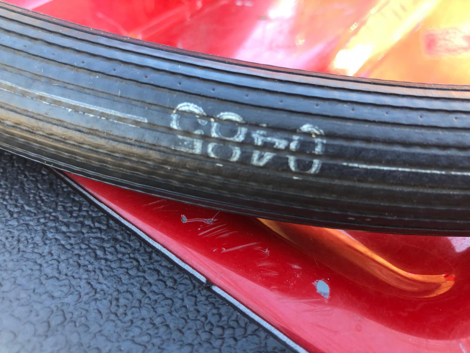

I have a a/c hose I bought in 2012 and was told it was to a 69 Camaro. I had not opened it until today and I do not think this is correct for a 1969. Any help would be appreciated as I want to sell it on the side but want to make sure what it is first.

Here's a couple of pictures of my assm line original hose. The hose material should be smooth....Joe

The part # 3949901 is for a 69 Camaro small block. 3949902 is for a big block. Your best bet would to see if it matches another Small Block. I have seen those ribbed hoses on lots of different vehicles, 60s/70s. And many were triple crimped instead of double crimped.
