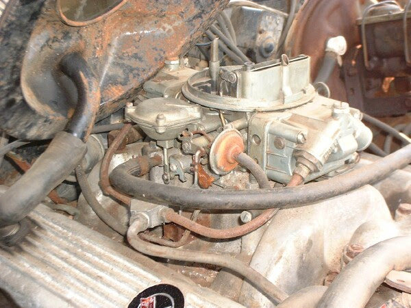

Question, I can't remember what is correct for an early 1969 350 Camaro vent tube from the valve cover to an enclosed air cleaner. Some were a rubber hose and others were a metal tube. Mine is missing and not sure which to look for. Thanks, Dave.

Here is the photo I originally posted.

The enclosed single snorkel had a metal tube that pushed into the grommet on the valve cover and went to a short piece of rubber hose that was connected to the filter inside the a/cleaner

Thanks for the picture but that's an open element air cleaner, I have a closed.

This is the hose I'm looking for, goes from the valve cover to the air cleaner on a closed air cleaner.
