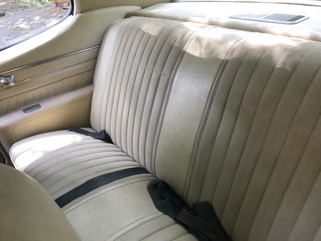

This was my 09/69 built 1970 Judge
See vent in package tray

So we know that 1969 Used the Seat Divider Mounted Motor with Duct and small rectangle Vent...
The 09/69 built example posted above used that style..
The 11D built example had switched over to the Package Tray Mount
The 05/70 car does not show the system but has the rectangle opening...I think that was there on all cars...Same Package Tray..
