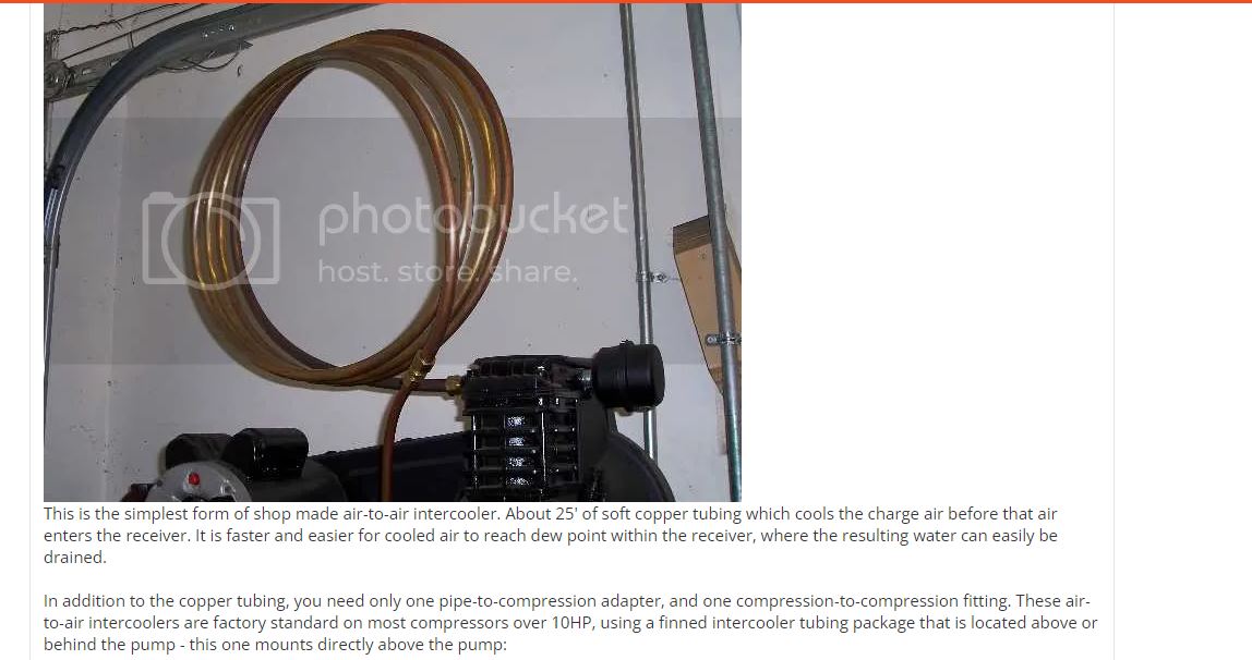

Paul you could probably check with a telescopic camera thru the hole on top were switch mounts into, with a bright light along the bottom welded seam and you can make this cheap air dryer and remove a lot of moisture that would otherwise settle on the bottom of compressor.
