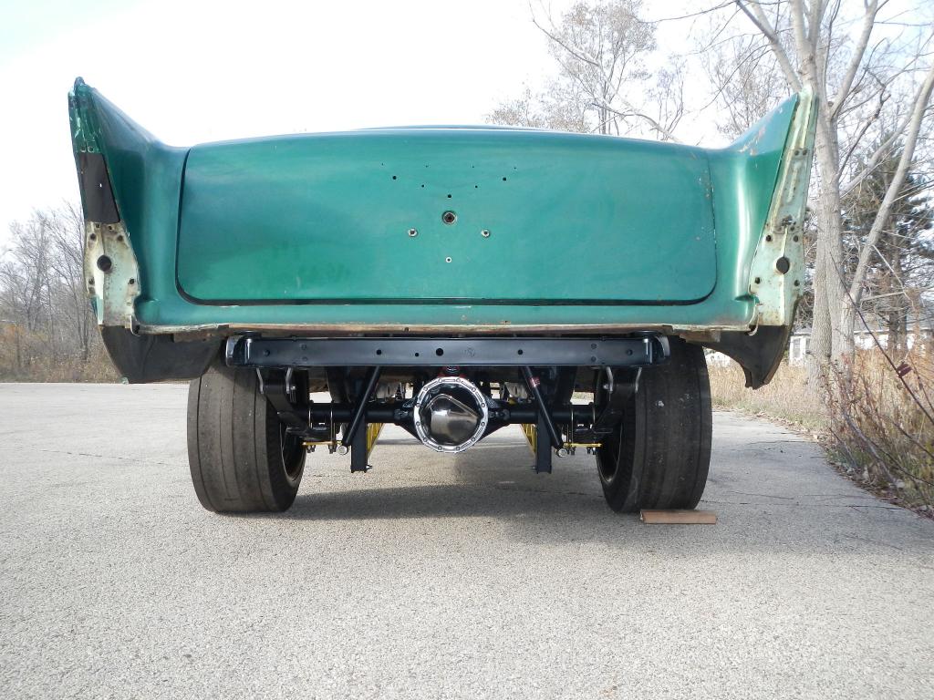

He had bought a straight axle stub about a year ago, and acquired a 1957 rolling chassis about the same time. We got the chassis on the frame rack and I cut off the front and, after MANY hours of measuring and leveling, finally welded the stub on.
After I cut the front off, the frame acquired a slight diamond, with the left rail moving ahead about 3/8". I put a porta power between the rails and easily pushed it back before welding.
