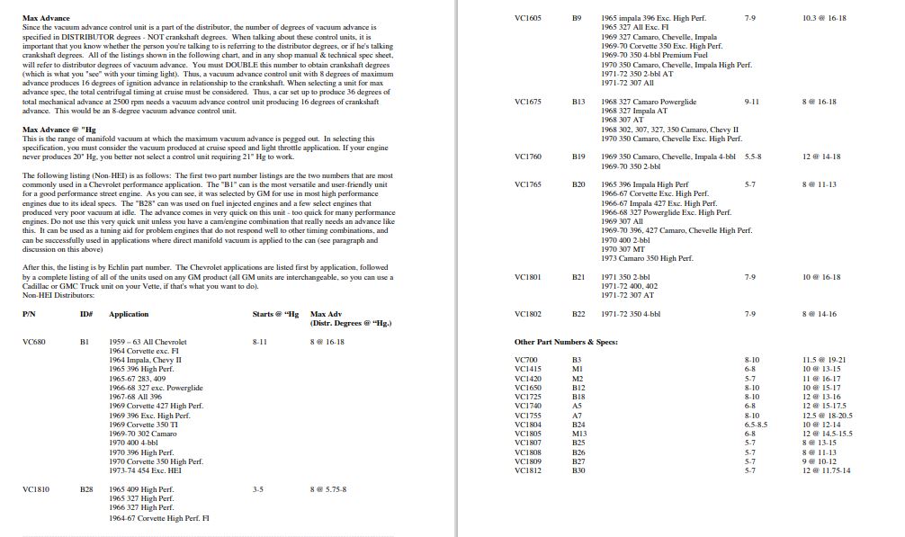

Can someone tell me the correct VAC for a 69 Vette L46 no air.
Thanks

Does this help?

Yes, I am asking for the proper vacuum advance canister for this application. Is it a B26, B1 etc.

If I recall correctly should be the same unit as you have on your L-71.

Default chart
This might help.
