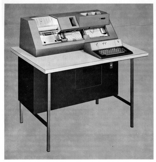

Given the numerous questions on what is basically the same general topic, I decided to explore for an answer in advance of the Christmas party, and the replies that I got were as follows: From the key punch ladies, "We keyed in what we had from the option sheets, what the machine spit out in the form of a completed punch card- well that could be a different story, and we did not have time to look or audit, that was done elsewhere"
From the Data processing guy: All these issues sound like defective switches in the key punch tabulation machine or more likely a punch card reader error .
This is a model 29 card punch station as used at Norwood from 1965-1972:

So what I am saying is if the program spool (drum) is improperly formatted then the error will be a constant, meaning if read by a reader it will be reproduced as an error carried forward.
The key punch machine by its self was prone to errors also. These were related to internal switch failures which would conspire to punch nothing at all, punch the wrong character, or punch no character at all.
Finally the reader had the same error pretext meaning that the error could be at the reader and the reader only- at the point in plant where the Body plate was being read and then the data transmitted to the Graphotype where the Graphotype then punches the plate with an error.
So what do we have? Like almost everything else simple human error. or failure to properly maintain the system. (Again root cause is human error)
Drum programming at the key punch (human Error)
Defective switch at the key punch (Maintenance Problem)
Key Punch error (human Error)
Read error at the graphotype key card reader (Maintenance Problem)
The consensus is that an incorrectly coded "bad programming drum" is the most likely cause of these batch anomalies.
