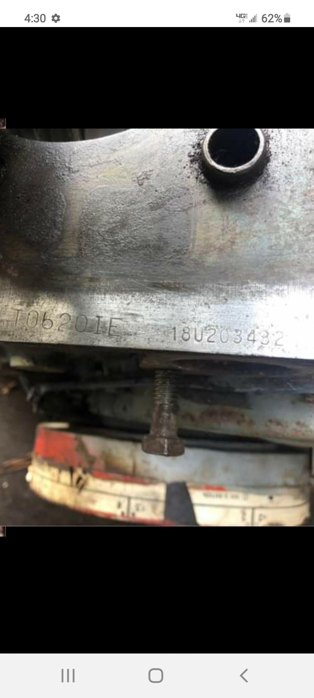

I ran across a gentleman that has a lot of 427 parts he wants to sell. What would be a fair price to pay for a 12 of 67 casting ID code block that is .060 over and the bore looks good. Thanks.

2K.....assuming It doesnt need 070 or 090

If you can clean off the surface where the partial vin is, I can check my database to see if the car may still exist. Looks like it starts 18D1 but I can't make out the rest
Thank you. I will go back next week and get a better picture for you. Do you track the 385 hp cars also?

Yes I do. Thanks! I track any loose blocks from a fullsize car 64-70 that have the partial vin
Its still not great. Car was in Delaware.

This one is a little better.

Maybe 18U15421_?
