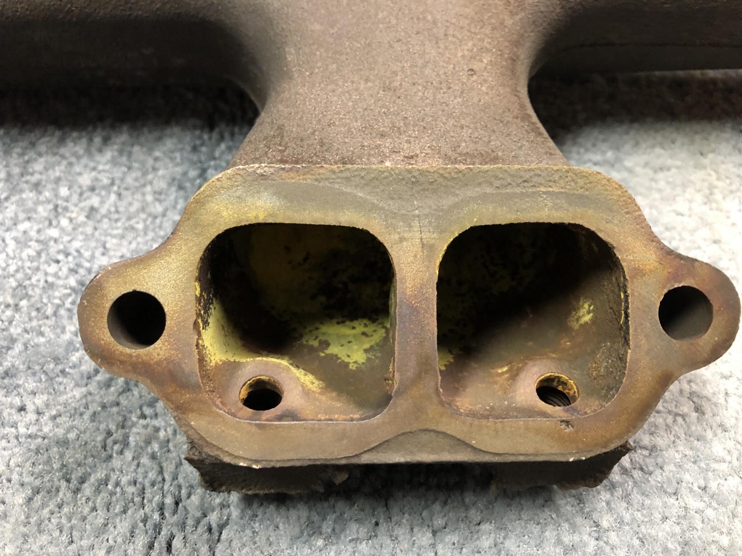

So I have these smog manifolds for well over a decade, probably bought at a swap meet. Original smog tubes on them, never been apart (till now) and original looking rust. Just getting around to cleaning them and found a crack, so disappointed.
Drivers side rear bolt hole, is it fixable? should I fix it? Crack does not appear to go into the bolt head surface. I have to clean the other and see if that has any issues
Any opinions? thx

I have heated cast iron exhaust manifolds in the oven on broil that were hot enough that it did not crack when I welded on it so it can be done.
You won't be "chasing" across the part, so you don't have to drill the end. Though if it were mine I may drill and pin that the piece - prior to heating and welding.

thx. I have been reading up on the Nickel MIG products for cast iron (hot method). Using a BBQ grill (which goes up to 500 deg). Also there is a cold method of MIG too. I have a neighbor who is a TIG expert, I will hit him up for his opinion (don't want to give him more work! ). I think I have another non-smog manifold that is cracked similarly to practice on.

Depends a bit on how much you want to hide the fix. If you don't want the outside casting welded you can V the crack on the face that mates with the head and weld that up. Then machine it back flat. Then bore out the bolt hole about 1/4 to 5/16 oversize and lightly press in a very slightly longer steel sleeve. The sleeve will take the stress of the torque on the bolt and the french lock will hide that its been sleeved. The weld will keep the crack from propagating further.
If you aren't worried about looks, it can be V'd out along its length and heated and welded up. You will still need to take a cut across the surface where it bolts to the head.

Hmm, sleeve-ing it is an interesting idea. Its the rear drivers side and will be tough to see under booster and master. So I am not too worried about looks, some grinding and manifold paint will lessen the weld. Thx
