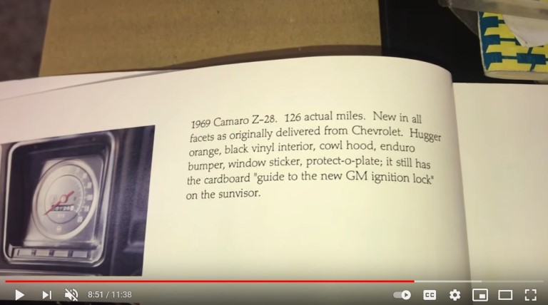

In the video he showed a Mecum auction book from 1991 that featured this car. At the time the odometer had 126 miles.
Cool if it can be verified.
