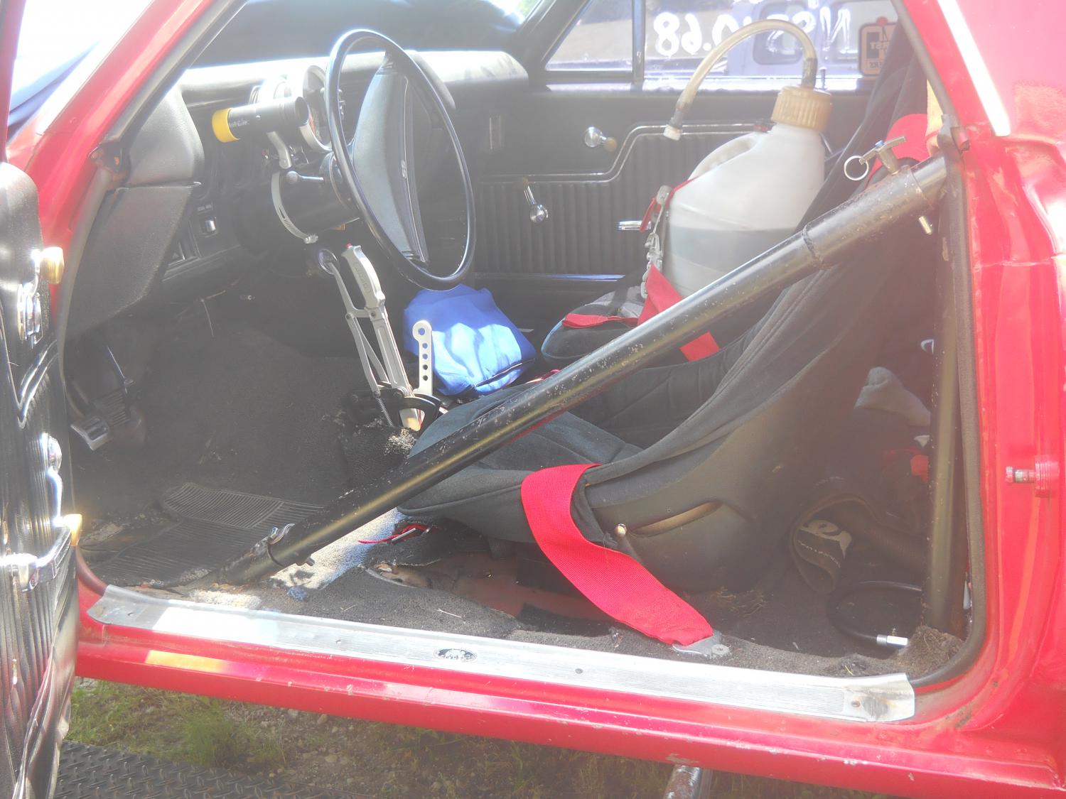

If you like solid lifter cars, the Elky is an old school 427NA BBC, 13:1 Compression ratio, solid roller, [email protected]., 4 speed, 4.88s out the back with slicks, best of 10.45@129.
As old school as it gets.

Thanks, it still has it's original interior except for the seats, was a bench seat, but couldn't get the seat to go back enough with the roll bar. Still has the factory gauges, heater, etc. Just don't have the heart to cut it up any more than I have to, it's a real W code Elky.
