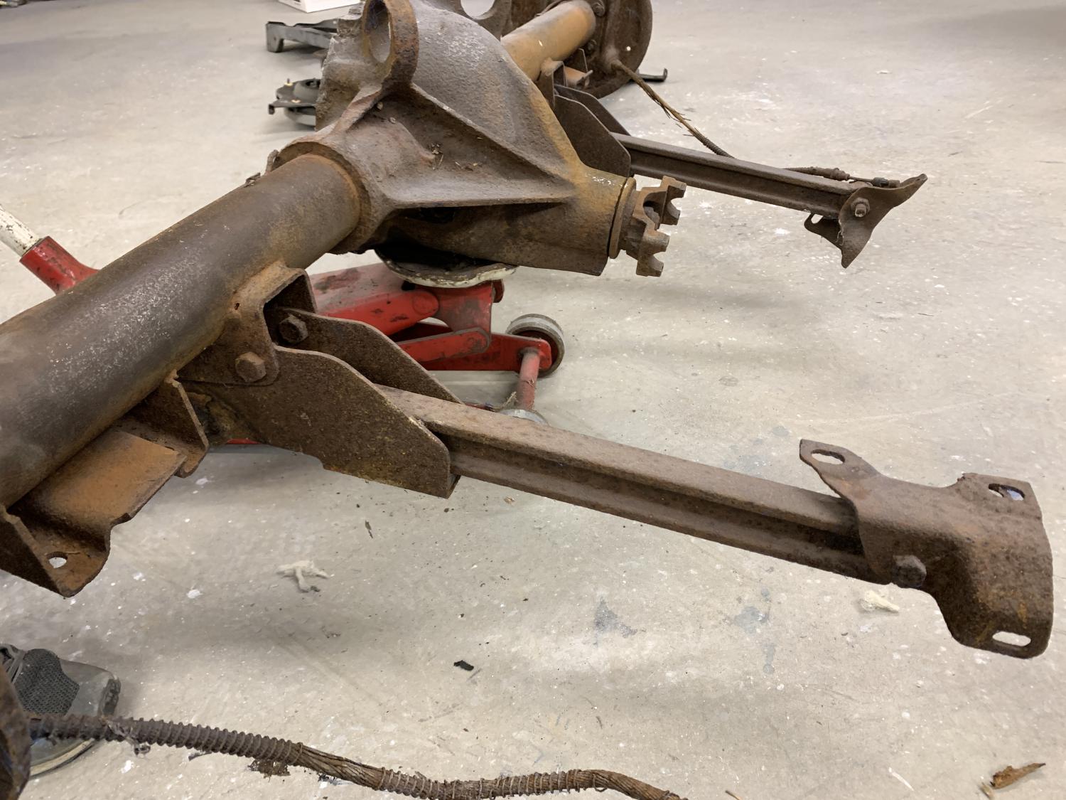

I looked at this rear in my friends shop yesterday, it has dual traction bars, everything looks correct & not a made up rear, it is a 10-bolt. We assume it is from a Firebird.

1st gen? The sway bar drops look diff than sec gen round type

That's a '67 Firebird rear end. They used the Tempest housing with leaf spring perches. That's why it has the eyes cast into the top for the A body upper control arms. It should also be 1 inch wider than a Camaro rear end. The 1st gen Camaro rear end is 60 inches and this one shoudl be 61 inches.

They work pretty well. They are a little stronger than the Chevy 8.2 10 bolt. After market parts are limited, but you can build a pretty good one. The Borg Warner differential that was offered in them was better than most of the after market stuff. I've reconditioned a few of them to make them almost new again.

Should also check the casting number on the back and look for a big N casted on the top front by the yoke to identify it as a nodular unit which makes it a little more valuable

Thanks again gentleman. Here are some updated pics. Casting # 9783393, it is hard to read the date, but has 3.08 original dated gears 1/67. The rear is definitely for sale, I am 20 minutes from Carlisle, PA, so I can deliver it to any of the upcoming Show's, Spring Carlisle is April 21-25.

I have all the rear codes for the first gen rears, is there something stamped in the tube by one of the ends? Should be a 2 digit code on the left tube
