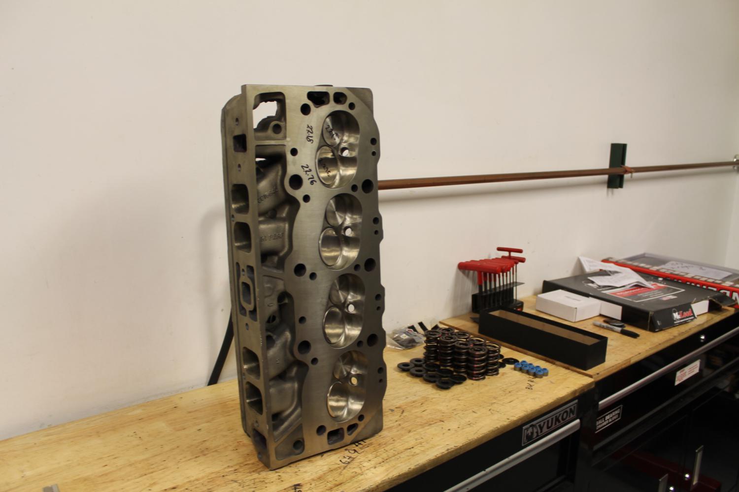

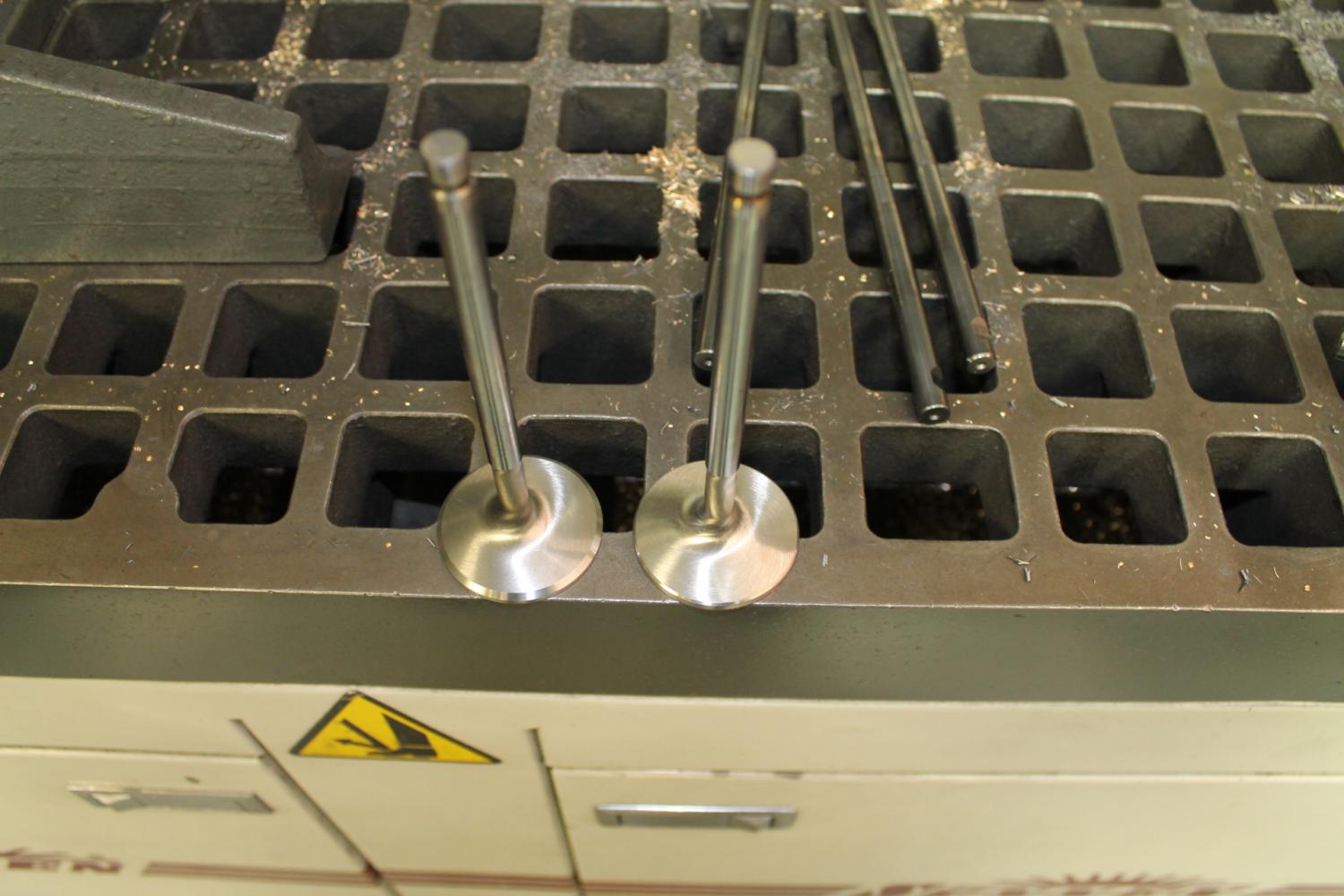

Finished welded 840 head, 1.80 exhaust valve, 2.250 Intake valve, 11/32 stem. Peak flow was 365 CFM short port and 370 CFM long port, 260 CFM exhaust port @ 28 inches, 109 CC combustion chamber.

Different collets on the intake and exhaust valves?
How close do you run the springs to Coil bind?
Very nice flow numbers

Thanks, I used a .050 short keeper on the intakes. I think it was .100 from coil bind.
